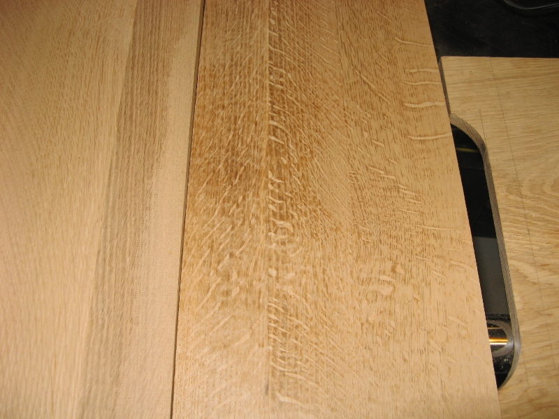

I bought my SS with jointer in 2011. It was delivered new to the original purchaser in 2003 so I assume it has the newest casting available.BuckeyeDennis wrote:Hi All:
The root problem appears to be that the face of my jointer fence is not terribly flat. Checking for square at alternate ends of the infeed table, I can detect a slight twist in the fence. In addition, I was able to see a slight concave bow (lengthwise) in the fence, which a good 24" straightedge confirmed. So I believe that the non-flat fence surface is thwarting my best efforts to keep the board at a consistent angle while jointing.
Then again, maybe being a fuzz off square is something that can be dealt with during glue-up? Any advice would be greatly appreciated!
While attempting the first project that required glue up I had unacceptable gaps after jointing . At that point I assumed the front and back beads were not Parallel. To spare all the details I found the beds were parallel within half of a hairs width on a Nat's back end so that meant the fence was twisted or machined incorrectly over its length. Takeing the fence to a machine shop was cost prohibitive.
My work around is, after jointing the edges I run the pieces Through the conical sander. I run the first board face up and the second board face down. This compensates for any variance from 90 deg. in the setup.
The three pictures are of my current glue up project. I am attempting to show the final result after edge sanding with the conical sander.
[ATTACH]23939[/ATTACH]
[ATTACH]23940[/ATTACH]
[ATTACH]23941[/ATTACH]
- JT1.jpg (386.24 KiB) Viewed 3565 times
- JT2.jpg (345.76 KiB) Viewed 3561 times
- JT3.jpg (385.44 KiB) Viewed 3562 times
