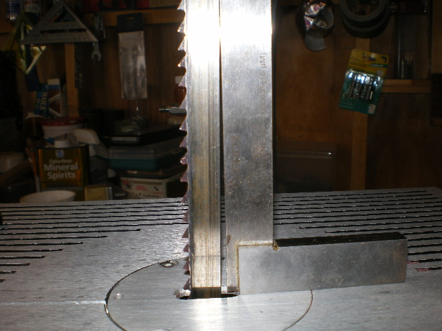

Bandsaw table to blade alignment
judaspre1982
- Posts: 1237
- bandsaw 002.jpg (126.96 KiB) Viewed 3259 times
- bandsaw 001.jpg (130.97 KiB) Viewed 3257 times

What you see is by design intent by shopsmith. The idea is to improve resawing. However when attempting to make other cuts this is not so good a thing.
There have been several discussions on the subject and some have shimmed the table to fix this. If you have two bandsaws you could have one for resawing and leave the blade/table as is. A second table could be shimmed for general sawing.

Here's the info from the manual that came with my 1980s SS bandsaw with the cast iron table:judaspre1982 wrote:I have 2 SS bandsaws both from the mid 90s. Both have aluminum tables.
I happened to notice that the tables are not square to the blade on the back side of the blade.
My questions are, is this normal? Are all the tables pitched like this? Does this have any negative affects on cuts in any way?
I have been looking to get better results when resawing and was looking at all the alignments.
I looked in the manual under alignment procedures and found no mention for that situation.Looks like I could shim the tables to get them square to the infeed side of the blade. But is this really needed?
