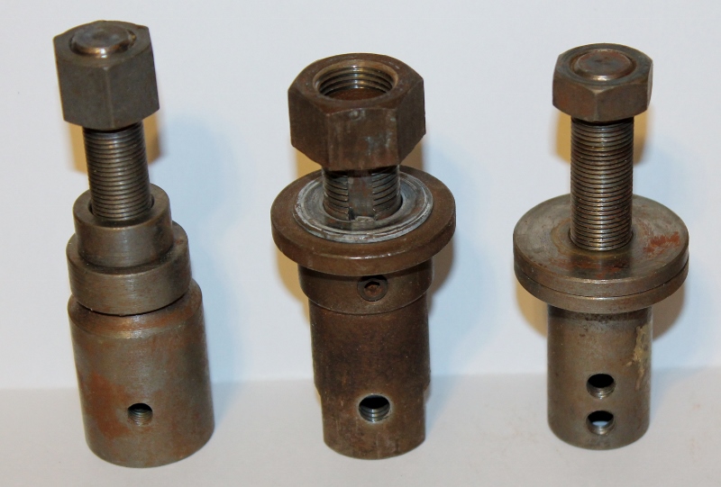

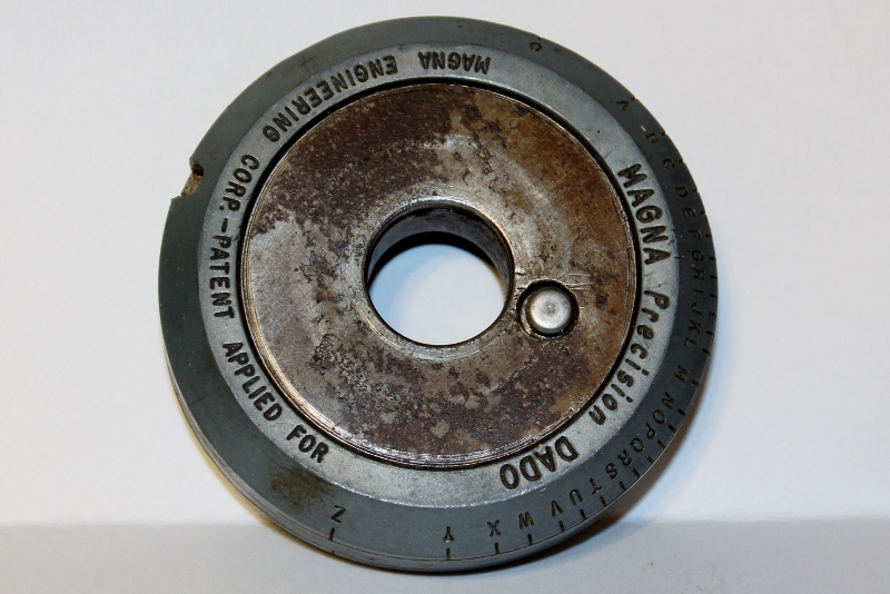

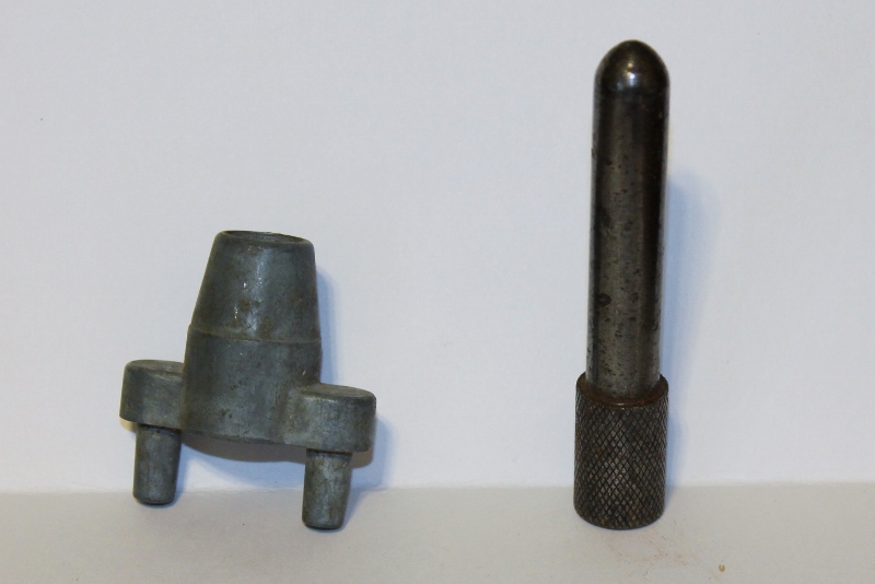

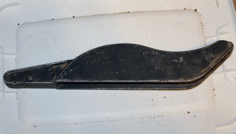

It's the fun new game sweeping the nation. Found these in with the various parts when I inherited the my greenie. The three arbors, are they for dados? Seem too big for that. There's a wobble dado, how do you adjust it? There's two other odd items and what is clearly a blade guard, but it's not to my Mark V is it?

Yup, what he said.wa2crk wrote:Top row left "shaper Arbor"
Middle Dado arbor
right universal arbor for buffing wheels
second pic I dont know on the left on the right possibly an ancient fertility symbol:D
THird pic adjustable dado arbor missing the blades
last pic an older upper sawblade guard. 10ER?
Bill V
That is indeed a Shopsmith 10E/10ER sawblade guard.
Instructions for the Magna wobble dado are available at http://vintagemachinery.org/pubs/791/3281.pdf

- Marilyn (item on the left) has a hole in through it so what it appears to be to me is some sort of cord feed or something. Big cord and possibly the two nubs at the bottom are tenons to locate it in some body.
- Fred (item on the right) has a knurled portion at the bottom, suggesting the top is the business end. Maybe some kind of ram for for a morse taper or something similar to that.

Pretty Peggy Sue may be missing some pieces. Definitely missing the blade which I assume is special for the dado but also some part of the body. Gotta pull her apart but I'd love to be able to use her, she's so rare and true.

Half right. Satisfy yer curiosity and 'move on.';)pds0006 wrote:2nd pic
3rd pic
That fertility thingy is likely an alignment pin. To what, I have no clue!
Second picture, item on the left - I can't tell the size but it looks to me like one of the old air compressors (?) I know they were shaped sort of like that but again, I can't tell how big the item is in that photo for scale.
