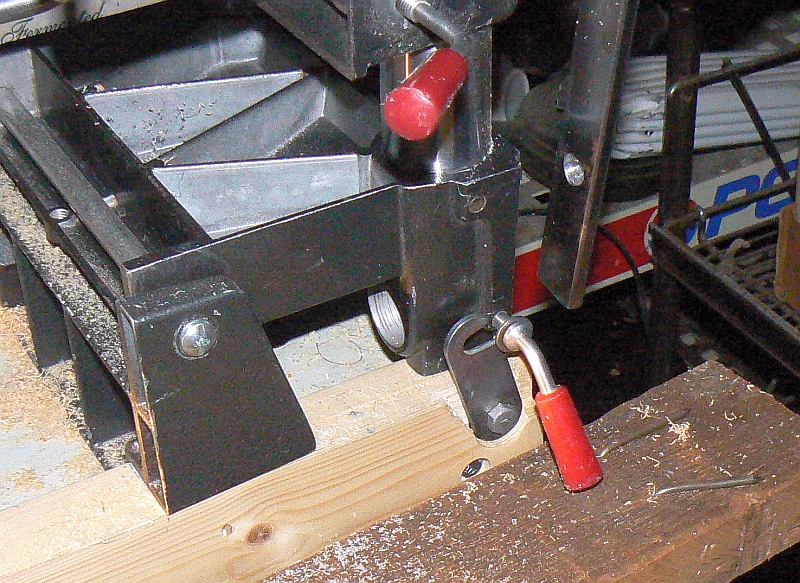

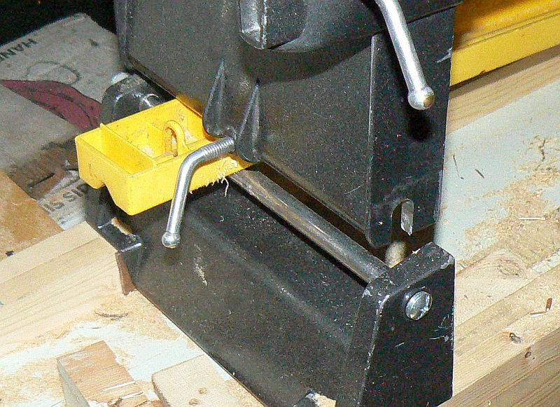

Some pix:
The table depth was extended. The single screw retains it(it cannot rotate).

The original rail was flipped and a Mark 5 rail attached.
[ATTACH]24169[/ATTACH]

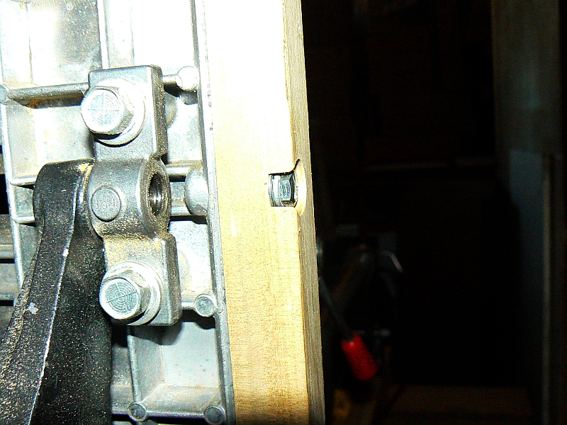

The vertical tilt lock. The screw is also one of the SPT clamping screws.
[ATTACH]24170[/ATTACH]

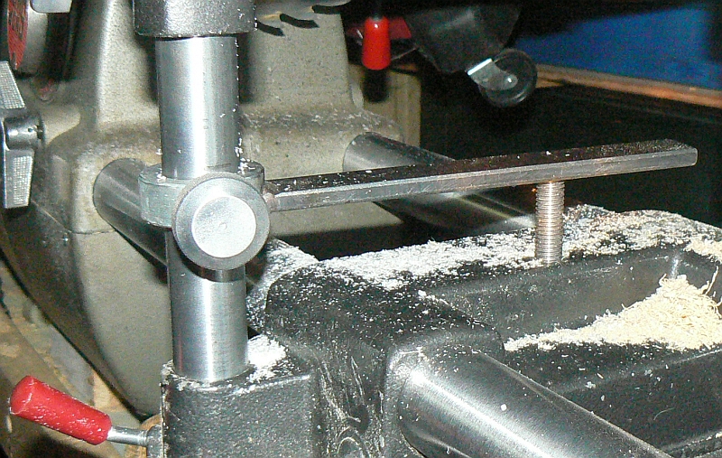

I had to make a table raising arm(ala '10').
[ATTACH]24171[/ATTACH]

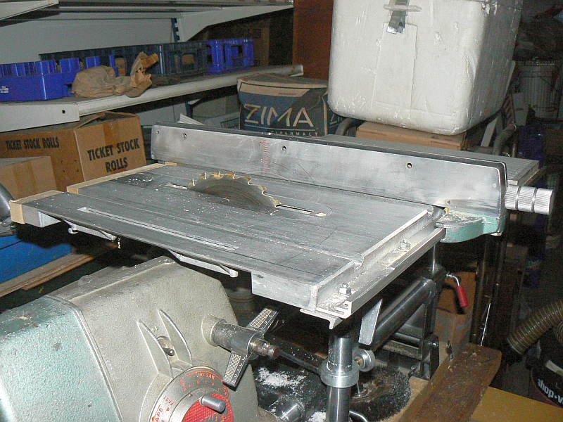

A precursor to the Mark 7.
[ATTACH]24172[/ATTACH]
In the last pix you can see the endcaps are mounted to doubled 1x4 that are grooved onto a 3/4" plywood center(the blue part).
P.S. The original pivot pins were retained with spring washers(think internal fingers). I drilled/tapped them and added screws and a spacer.
[ATTACH]24168[/ATTACH]
