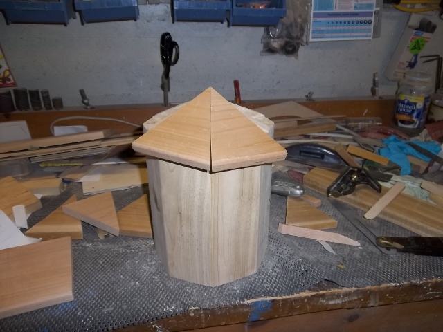

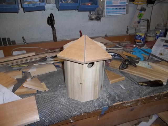

I Think I have It
I think I got it solved. Now all I have to do is make sure I can repeat it 8 times.
The first picture shows the problem gap. The second shows the adjoining edges cut at a 11.25 degree tilt. They don't quite match as I was pretty well doing it freehand with the previously cut pieces. Hopefully cutting new pieces using the correct angles will give me the results I want.
Thanks again for the help.
John
John
