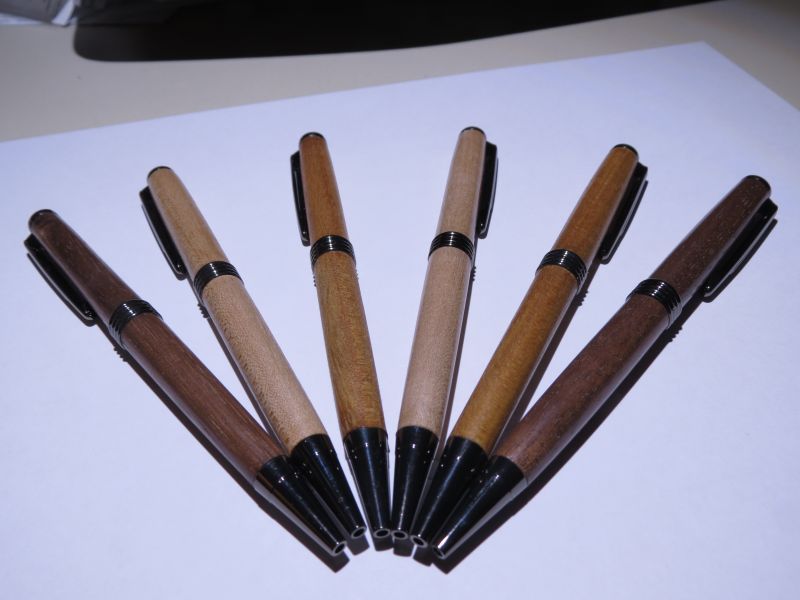

Thanks for the reply's!
Well as a the best plans go my eight pens turned out to be six pens.
The batch of kauri wood blanks I got had a couple that were questionable, a natural flaw in the wood that I was wondering about. I saved those two until today, one turned fine, one broke apart..... That happens.
Something I had not had happen to me before got the other one. The wood turned and finished fine. When I assembled it I thought things were OK but when I put the refill in to test the amount of exposure it was fine but it would not retract. I tried a few things but it was not going to work, so I figured I might as well try to save things my removing the insert. That turned out to be a bigger task then I planned. I got it part way then resorted to tapping on it with a washer by the end and an open wrench on the shaft, all held in a vice. A couple taps in and the vice let go........ It flew off somewhere but I could fine it. Might be wrecked or still stuck who knows???
I already have presentation bags, while from another supply I have a feeling they are all the same. I will store the pen in that bag, it should be good for years. The refill I will put in a plastic snack bag and seal. If it were to leak the ink should be contained by the bag. It should also keep the refill "fresh" at least for a while. On the out side of the plastic bag I'll write down the make and model of the refill.
I was thinking of finding a small box to put it all in and a note about the pen and when it was made etc. I'm also thinking I give it to the parents to store with the child's name on the box.
[ATTACH]24341[/ATTACH]
If anyone thinks of some other great ideas I'm still open to change for a while yet.

- IMG_1401sc.jpg (49.2 KiB) Viewed 2055 times
That is called 'slim line'.idcook wrote:Very sleek design.
Hi,
YFI about these pens.....
In this particular series pen slimline are 3/8" these shown are 7/16" one step up so to speak. They have 1/2" and then "cigar" at 9/16" and "gentleman's" at 5/8". Other series may or may not have the same sizes and labels.
The way I took the photo makes them appear thinner then they are. By way of reference a Bic pen I have here by my desk is .320", (across the octagon) of a wood pencil .285", one of the pictured pens .438".
