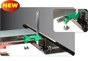

Hi Ed,
That was one of my biggest concerns! I went out into the receding lake I call a garage (WAY too much melting snow for the french drain to handle!) and brought in a SS miter gauge along with the 1000SE (already had the sled inside)
It appears that I can use the same rear fastening point by replacing the one screw, The aluminum block will probably have to be custom because the holes where it would mount on the V120 are not the same as the 1000, but that is as simple as buying a chunk of aluminum which I'd have to do anyway and having one big hole tapped and drilled and two smaller holes drilled to attach to the angle plate
At first glance, with the 1000SE extended fence attached, the amount of material that would be held down by the grip is just the width of the shoe. :mad:
A while back I did buy one of these
[ATTACH]24342[/ATTACH]
so I might just see what I can with it.
I did look at the position of the v120 and 1000SE in relation to the angle bar and they seem close. If I want to remove the extension bar from the 1000SE, I presume that will give me significantly more space!
Maybe I should forget about speed and just be excited I can do it at all! :p
Thanks for the ideas and insight!
