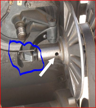

To answer a couple of your questions, you can't directly upload videos. You can upload videos on YouTube and put links to those videos in your posts.
There is supposed to be a connection between the speed control mechanism and the sheave. It is a button bearing with a wire loop. See the area inside the blue quasi-circle in the photo below (the white arrow points to an oiling hole that the older Shopsmith's don't have).
[ATTACH]24393[/ATTACH]
With inadequate oiling, that bearing seizes up and either the wire loop that connects it to the pork chop breaks off or the whole bearing falls off. In either case it is probably hiding in the motor pan, under the motor. It isn't intended to be a user replaceable part. I believe it is a press fit and some users have managed to reattach. Bill Mayo who is one of the real experts here (I'm just a poser) may chime in. Otherwise buy a new sheave assembly from the mothership (hope they ship to Canada) or buy a used assembly from ebay.

it might be a bit hard to see. the wire hoop is present, but the piece on the shaft appears to have broken off.. i would have thought it would have taken the hoop with it?
also, the ball bearings inside the bearing appear close to falling out. so thats obviously a problem
question is, is that the only problem?
