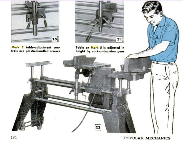

If you are referring to a Mark II, I believe Model 5 (500, 505,510,520) blade guard or riving knife parts will not fit, though you might be able to adapt one. Here is a pic from a March 1958 Popular Mechanics of a Mark 2 with a blade guard (so they did exist):

By the pic, it looks to have only the upper guard.
