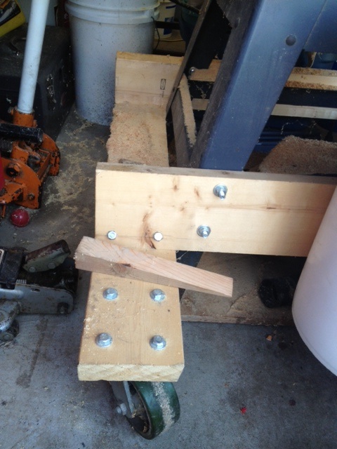

I fought the tiny wheels on my table saw for years. I kept them lubed and clean the best I could, and it was always a fight to move or more accurately, scrape the saw across the garage floor. I did the concrete myself, but it wasn't THAT bad. Really. So here is what I did. It works wonderfully, and there are four of the little wood wedges, one of which is shown, that I kick under the plywood to anchor the machine in place for use. I manage to keep the height about the same as before. I like it so much, I think I might do this to my green machine, rather than buy a metal caster kit. What do you folks think?

It's like the guy I saw once who put a Fram oil filter on an old Panhead. He'd ridden across three states on a thirty plus year old motorcycle, and he was not there for the show. Hard to argue with that.db5 wrote:UGLY but effective. But I don't have a pretty garage either.
So how well do the SS retractable metal casters work anyway? The Craftsman ones were absolute junk, which led me to the above solution. I can do this without drilling any new holes.

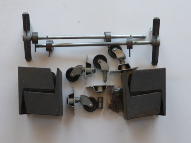

[ATTACH]24399[/ATTACH]I just replaced the castors on my 1990 510 with the larger ones I got from Bill Mayo. Amazing difference. The original castors are in good shape and you may have them for the shipping cost if you want.
An alternative is adapting some very good castors with the other parts to make it work from a 1960's Mk. VII. I have those also but they are not free. Can be had for a reasonable fee.
I no longer have the grey metal parts of the frame so you would need to just adapt the castors to what you have. If interested PM me.
- P1070186.JPG (76.45 KiB) Viewed 1698 times
Thank You for the 'exploded parts' pix.db5 wrote:[ATTACH]24399[/ATTACH]I just replaced the castors on my 1990 510 with the larger ones I got from Bill Mayo. Amazing difference. The original castors are in good shape and you may have them for the shipping cost if you want.
