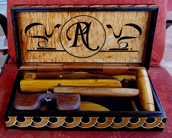

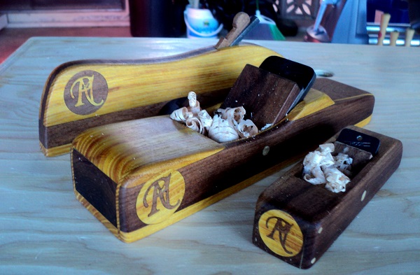

I made a few woodies last fall with blades from Ron Hock and mesquite and osage orange from Gene Howe. Hock Tools makes great blades and I love the planes.
They are a joy to use. I also had to make a nice box to keep them in of course. Make no mistake these are excellent working planes ... not just another pretty face.

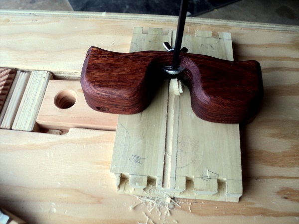

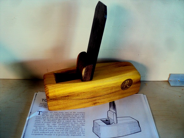

I also made a toothing plane with a blade I got from Patrick Edwards (American School of French Marquetry) and a router plane with an allen wrench blade.

I would encourage you to make some (wood or metal) if you are leaning toward it. They make very rewarding projects that keep giving you pleasure every time you pick them up.

Is the router plane 'blade' made by grinding the short arm of the allen wrench flat across the 'points'(bottom with slight relief) and a bevel ground on top?
Looks like a thumb screw with drilled hole holds the 'blade'.
I like the simplicity of it. I have been considering getting one.
Is it possible you also ground the sides(original wrench points) to desired blade width?

That's pretty much it JPG. This is the article I worked from. Mine is a totally different shape because of the scrap I had on hand and the way I wanted it to fit in my hands but the works are all made just as the article describes. It works remarkably well.
Better pictures of it here.

Thank You for the article link!shipwright wrote:That's pretty much it JPG. This is the article I worked from. Mine is a totally different shape because of the scrap I had on hand and the way I wanted it to fit in my hands but the works are all made just as the article describes. It works remarkably well.
Are they 'always' pushed? Can they not be pulled as well?
Would not a slot in the wooden base behind the 'blade' assist the thumbscrew in keeping the 'blade' vertical?(cutting edge horizontal)
