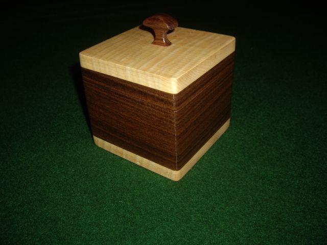

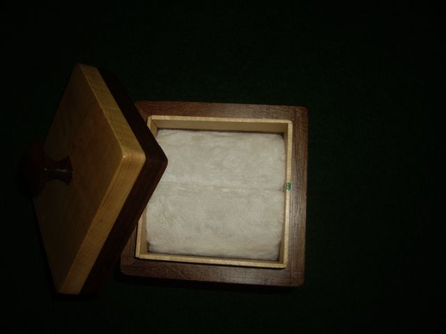

Just finished this ring box for my son's wedding.
3/1/2 high and 4" square.
Walnut and Maple. Finish is Watco, Poly and wax.
Tried something new for the lid locators. I cut a shallow dado in the blank of walnut before cutting the pieces for the box. After the bottom and top were glued on, the cut separating the lid was made leaving a bit of the dado in the walls of the lid and a larger part of the dado in the box. The maple lid locators were glued in the box dadoes, leaving a smooth interior.
Thanks for looking.

That is beautiful work. Amazing what you can make out of wood.

Nice work Gene

What a beautiful job! Nice work!

Great looking gift!, and what a souvenir.
John
like John said!!! Very nice work that will be treasured for many years.

Great job looks good.

Looking good
4" x 3"? My god how big are their fingers?:D
Nicely done!:)

Gene,
It looks great! What kind of poly did you use and how did you apply it. That was my biggest challenge on my last project. I couldn't get it to smooth out enough. It got smooth but still had uneven patches.
