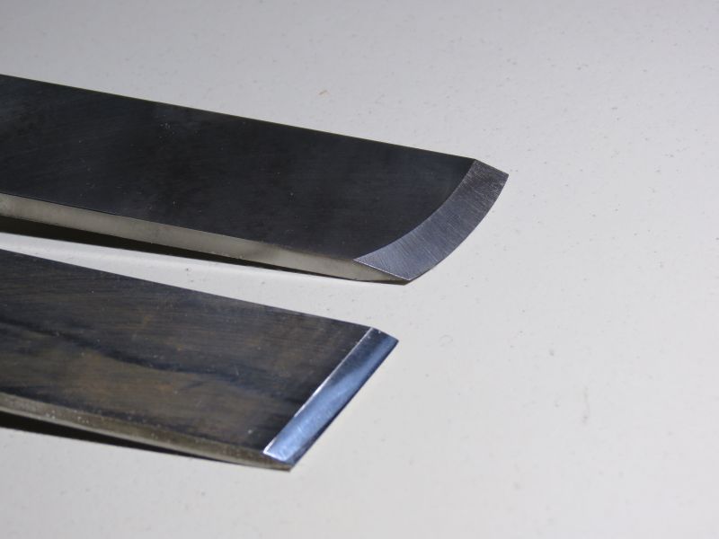

Pictured below are the stock chisel and then the new curved version.

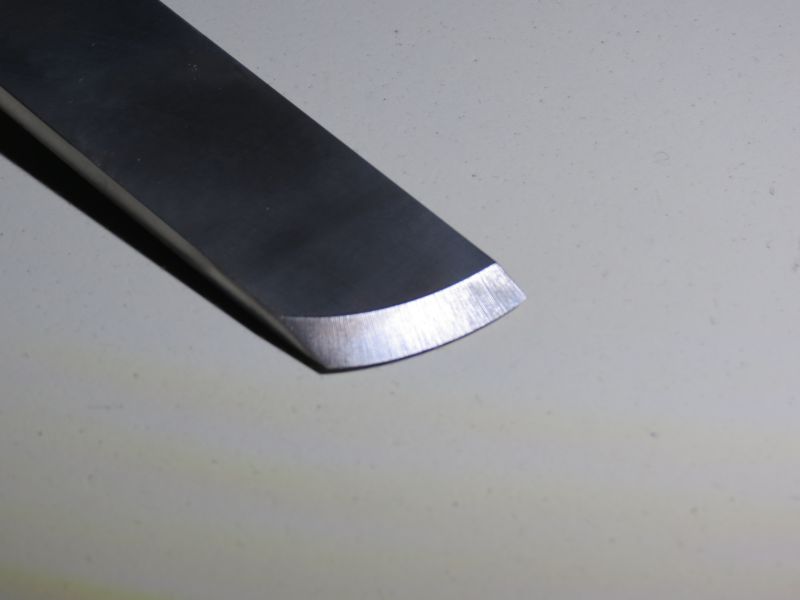

Here is another shot of the new tool.
[ATTACH]24533[/ATTACH]
I still have to sharpen it as this is straight off the 80 grit wheel. Also need to round the edges of the blade.....

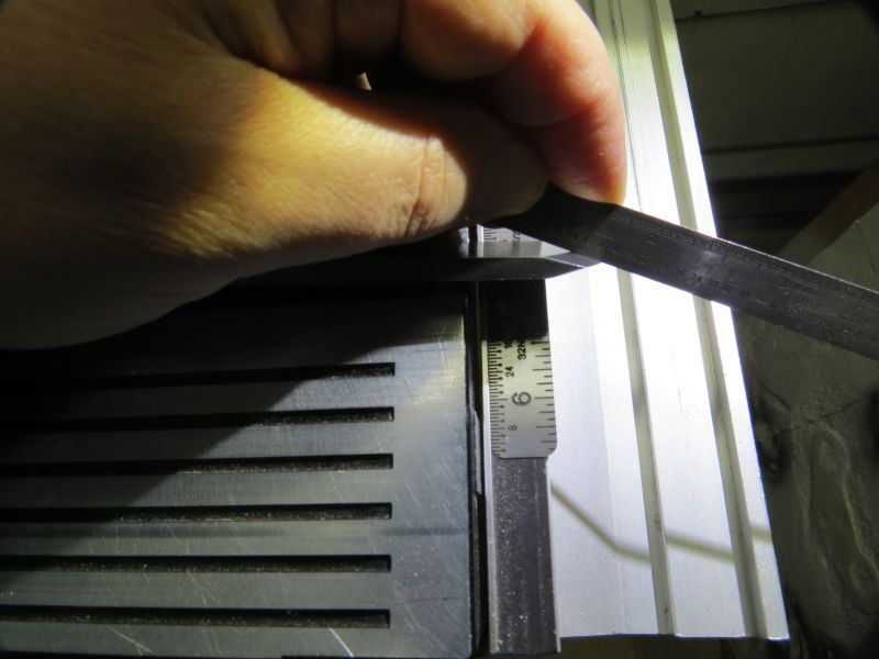

Got out to the shop for a short while and checked the angle, It is pretty much on 25 degrees.
I also shot a picture showing that this was a flat grind, not concave, not convex just flat.

I will have to check out the video again, I've watched it before but I don't recall all the details. I do believe he is showing a rounded edge skew in this video so I have had no experience with this sort of tool and I will most likely purchase one rather then modifying anything I have.
