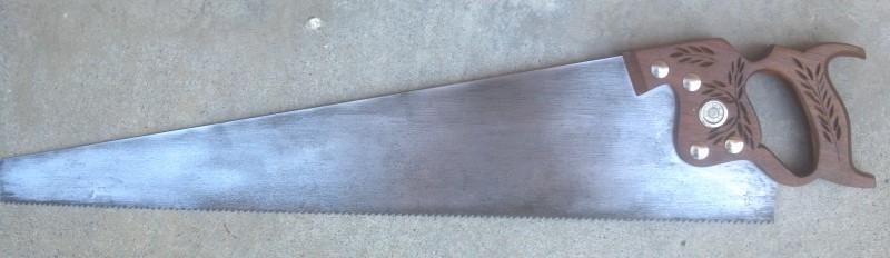

Or use the old stand by
Table saw as much as you can and then hand saw the rest. I can get 3 inches on my SS. Then I follow up with this
Disston D12 5 1/2 TPI filed Rip Cuts like Buttah!
[ATTACH]24635[/ATTACH]
