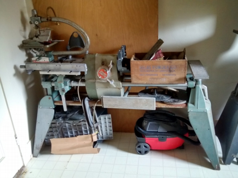

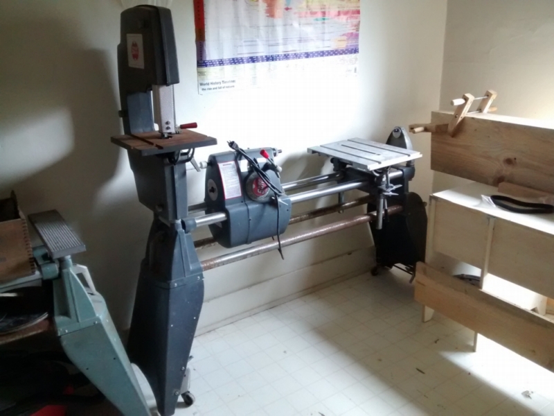

After years of covetting a Shopsmith I picked up a 1982 Mark V 500 with old style jigsaw (poor shape), bandsaw (good shape), 12" planer (good), bunch of blades for table and bandsaw, sanding disks, etc. for $250. I also got a freebie greenie. At least I think it is a greenie but I'm colorblind and it is missing the serial number plate. That $250 is a lot to me but I would have paid more than that for a decent used bandsaw and drill press (been looking), plus I've wanted a shopsmith since around the year the newer one here was built (I was 10 then!).
[ATTACH]24688[/ATTACH]
Newer one.

Older Greenie hiding in corner with planer undernieth (won't stay stored that way), jigsaw, etc.

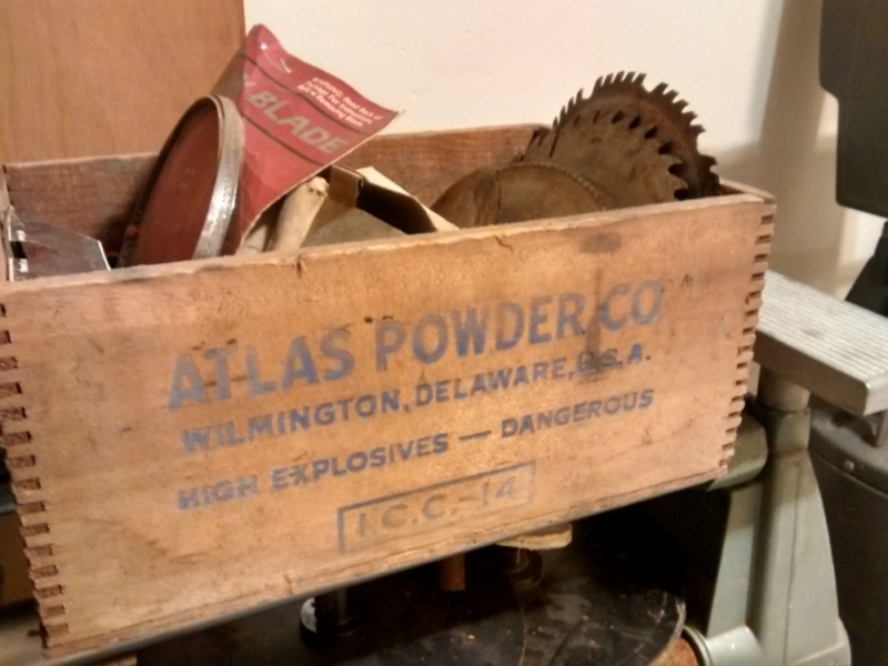

Box of blades - most rusty. Check out the writing on the box. I only noticed that just now!

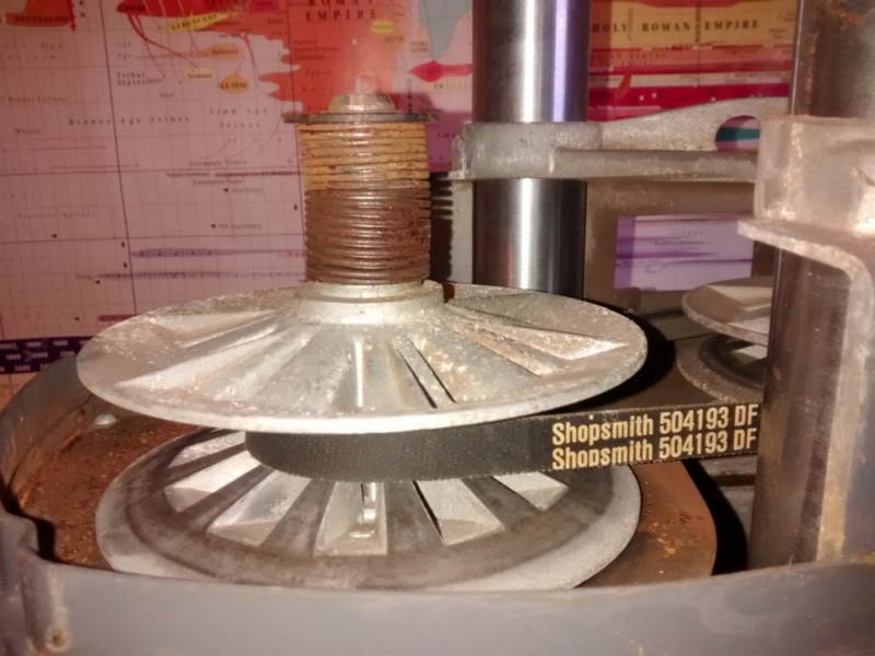

The later model seems in OK functional shape though it has not been stored well at all, rust along the lower tubes, light surface rust, dirt, crude, whatnot on other surfaces. I've done the periodic lubrication as listed online, but I have never seen one in action. It seems smooth, changes through the speed range OK. Case vibrates a little at one speed. I ran it on a low speed for around 20 minutes using a sanding disk and the case was just a little bit warm.
The earlier model was included "if you want it - I think it is broken." It wasn't frozen so I tried turning it on... it worked for a minute, made a noise, and I hit the switch. I opened it up and out fell half the speed adjusting gilmer belt. Well, the motor seemed to run OK after that. I'm going to try de-rusting and cleaning up this one first for the sake of practice but will probably hold off on replacing any parts until after the newer one is all set.

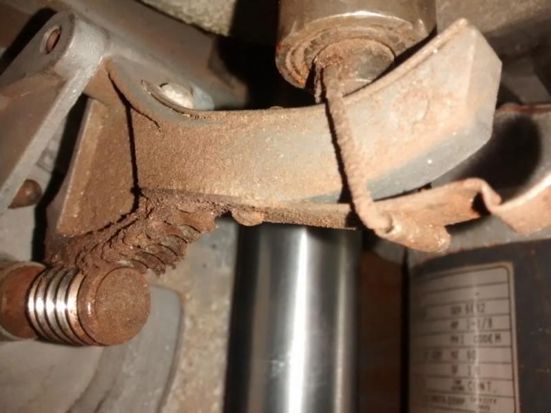

A couple photos of the interior.... looks dirty but I don't see any broken teeth:

BTW, I love that wooden crate - that is a great one!

The photos above really don't show the state of rust on the lower tubes on both machines whatsoever. It was much worse than the photos seem to show! The bandsaw table and tubes I've done look great
