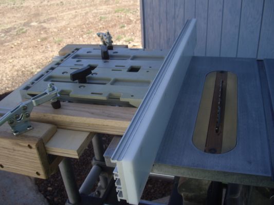

Here are a few pics of my new Incra table saw fence.
A pair of Incra jigs attached to a piece of 3/4 BB for fine adjustment. A pair of T tracks and inserts on the under side of the jigs for gross adjustment. Metal clamps to hold the gross setting.

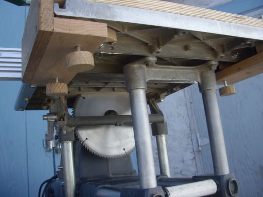

A view under the auxiliary table showing the wooden clamp system. Actually two joined tables.

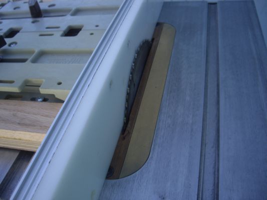

Before clamping the jig to the table the fence is extended to register it against the blade.
[ATTACH]24693[/ATTACH]
Registered. Now the table clamps can be tightened.

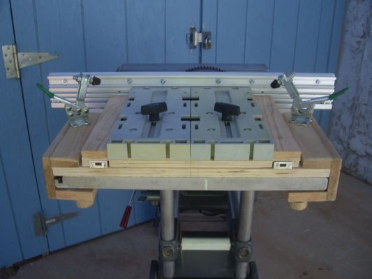

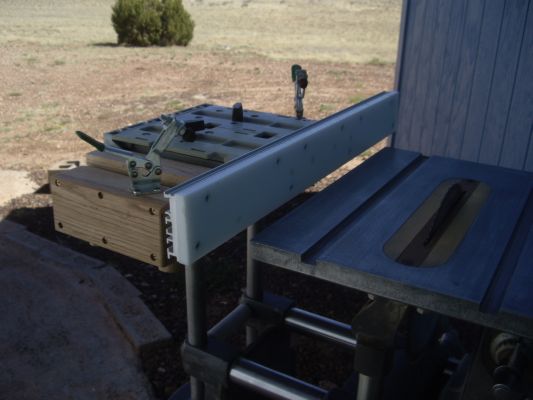

Then the fence can be pulled back. In this case, a bit farther than necessary. And the metal clamps are closed to hold the gross adjustment.
[ATTACH]24696[/ATTACH]
Finally, the Incra jigs are adjusted to the precise measurement needed.
It took much longer to type this than it takes to set up the fence.
In just 2-3 minutes I can be dadoing, grooving or cutting.
Thanks for looking and all comments are welcome.
