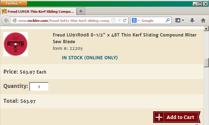

rlkeeney wrote:I use this on my old Craftsman Radial. It works very well. Nice smooth cuts.
I did not see max cut depth(thin kerf area od - thick body od).
Belay that! 2 3/4" 1/2"minimum????
P.S.[ATTACH]24862[/ATTACH]
- freud ras blade.jpg (96.41 KiB) Viewed 4831 times
