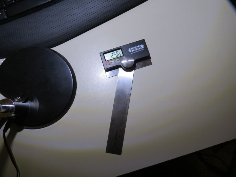

The package says Pro-ANGLE (TM) and No. 1702. It should be pretty easy to locate using google or other search engine.
[ATTACH]24868[/ATTACH]
General information
absolute and relative measurements
accuracy 0.1 degree
resolution 0.05 degree
range 0.00 to 180.00 degree
display can be inverted
hold function
It uses a CR2032 battery, not my favorite but there is no room for anything else.
Zeroing is a little strange and from reviews it is clear that people don't understand how to do it. Lay the tool head and arm against a flat surface and push the zero button. In this mode you read from zero to 180 degrees and seems straight forward. The strange part seems to come when people want 90 degrees to be zero.... Some are using blocks with 90 degree surfaces etc. The way I do it is bring the arm to 90 degrees, lock it in position and then re-zero. So far that seems like a fine way to do things.
The locking knob does a good job in keeping things from moving but you can still force it. I personally would like it to lock a bit firmer but I don't see any big issues with how it is.
I picked this up locally at a Lowe's store for $19.11 so the price wasn't to bad.
I'm happy at this point but of course longer term use might change that especially if it fails in a short while.
Out 8 out of 10 on this, 1 point off for no apparent warranty and 1 point 'cause I'd like the arm knob to tighten better. Still a pretty respectable score cause I like how it works and like the size. Looking forward to trying it on several other projects and on the ringmaster.

Sounds good, but
I would think the very short reference surface might be a hindrance. But it would fit small spaces.
Let us know your experience.

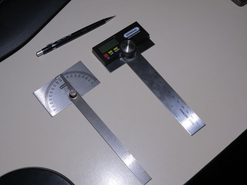

I thought this might help with understanding the relative size and purpose of this tool.
I've had the one on the left for a lot of years now and it has been a mainstay in my shop. When I was working in a machine shop these were a requirement for a lot of the things I did. I couldn't afford a better one but the Craftsman turned out to be a pretty good tool.
The mechanical one gives you 1 degree readings and allows a pretty good guess to 1/2 degree. Well it did with younger eyes.
