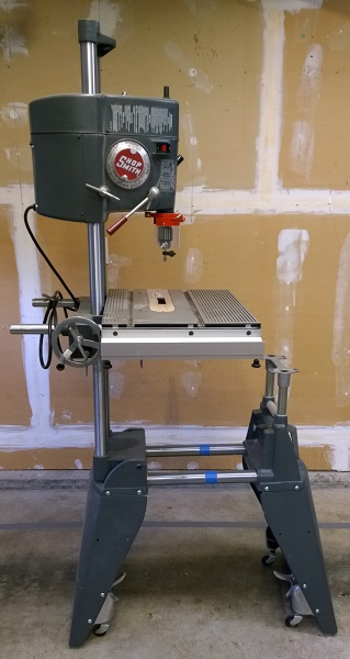

[ATTACH]25179[/ATTACH]dusty wrote:This sounds like an interesting configuration. Can you post a couple pictures.
What I am trying to envision is what it is like when not vertical (drill press).
That's a photo of what I have been using. The blue tape indicates where I am going to shorten the bench tubes. Since the headstock and table have been reversed, I no longer can (or want to) lower it into horizontal mode in this setup. I will likely add a small piece of plywood to expand where the SPT tubes are making contact under the table for stability.
Overall, my plan has been to be able to use this as a dedicated drill press most of the time, and then also have it as an OPR station when needed. As such, would like the headstock to be able to be raised, and the table to be lowered. Given that, either having jack that is easily removed, or a pulley setup that is non-obtrusive is ideal.

Food for thought.damagi wrote:[ATTACH]25179[/ATTACH]
Since it is tall with a short foot print(about to get smaller) consider reversing the base hinge. This would also require reversing the tubes etc. as well. That would place the center of gravity closer to mid way between the legs, and move the headstock and table closer to the 'operator'.
One little detail is missing; how to lock it down.
[quote="JPG40504"]Food for thought.
One little detail is missing]
Yeah, the tipping issue is definitely a bit of a concern. One thought is, once the width is set, to build a cabinet underneath for drill bits and other accessories. Once that is added the center of gravity should be a bit lower...can always add a patio paver
I also figured I would use some cutoffs from the other shorty I am doing to make a place to hang the OPR when not in use. I was sorta hoping that it could hang from the bench tubes...but alas, as we all know those are a bit wider than the way tubes. Ah well.

One other 'detail'.
The hinge 'feet' will not fit between the bench tubes.
So fagetabotit(unless you want to machine them to fit the waytubes).
One other 'detail'.
Figures.JPG40504 wrote:*%^%$
One other 'detail'.
At that point, It would make as much sense to ditch the bench legs and such and build a fully custom base. That would basically be a wall mount setup on a portable stand. Not a bad option....hmm
