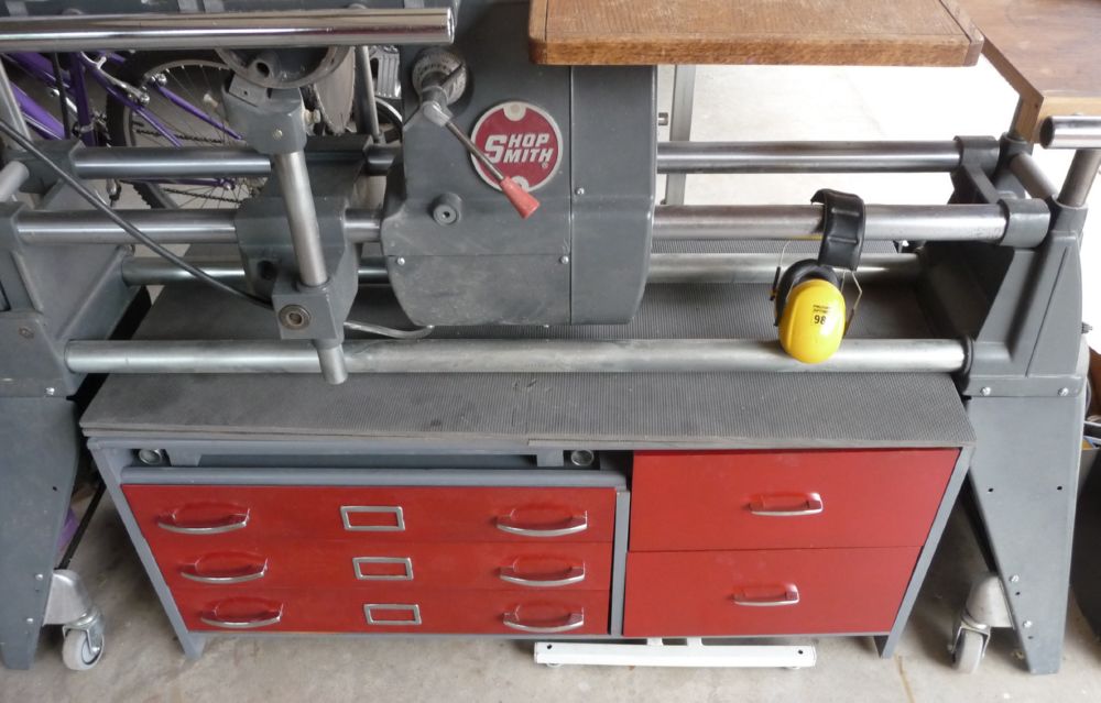

have very limited storage space for the Shopsmith (the space between two parked cars). The cabinet I have used for years was very inconvenient and made it difficult to get out of my car when it was parked in the garage.

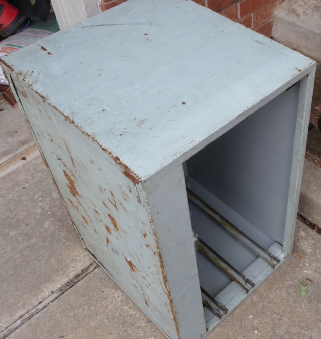

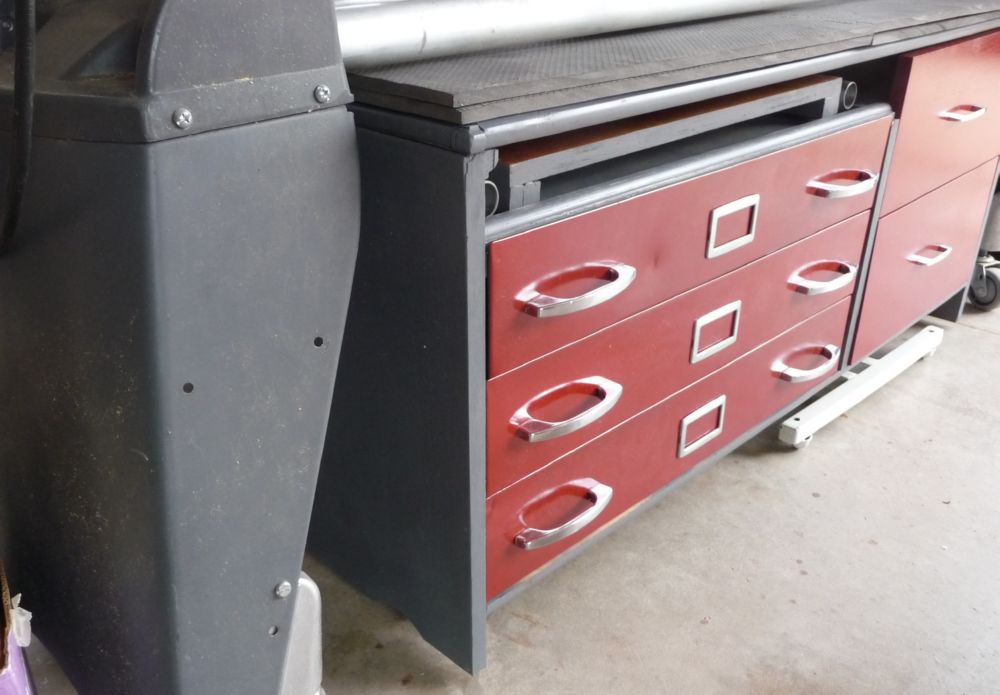

I finally built a storage unit for under the Shopsmith. Almost everything was from what people threw away or was cheap at garage sales. The 3 large drawers are from a metal cabinet that a friend who was moving gave me 30 years ago. It was too tall to fit under the SS. I didn’t want to spend money for drawer slides so it slides on rails. Not optimal but free. Construction was dictated by the height of the drawers and I wanted space at the top to store my router table top as well as room on top for two mats and space at the bottom to slide the Hospital tray table underneath. This dictated that the only wheels that would fit were roller-balls from Harbor Freight. This created an unforeseen problem.
Whenever I want to open a drawer the cabinet rolls. I need to use some sort of floor stop. One that might work is the rubber wedge but it is a hassle. I doubt that the hinged type will work. Another option is much more elaborate and expensive. I have 7cm clearance from the bottom of the cabinet. Of course I have room to add an external runner and attach something to that. Any suggestions on how I can make something?

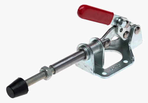

I think your storage unit is admirable. You could mount one of these toggles to either side to anchor it when in use...

Shopsmith doesn't sell that style. I found it here.

There are many versions of this clamp. I wish I could find a catalog that showed them all.dstensland wrote:I think your storage unit is admirable. You could mount one of these toggles to either side to anchor it when in use...

Thanks, Dusty. I think that is the solution. Found them on Amazon ($14 for two).

http://www.destaco.com/clamps.htmldusty wrote:There are many versions of this clamp. I wish I could find a catalog that showed them all.
