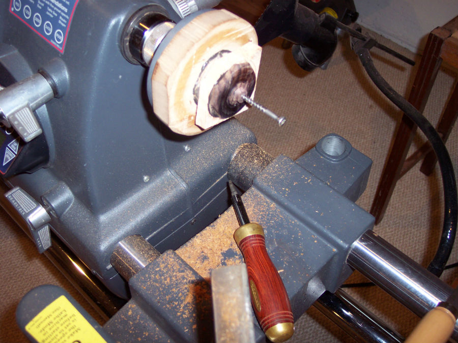

I used the following 'jig' in my repair. This lathe faceplate is used on 90% of my turning jobs; I love having a solid glue mount most of the time. But this time I put in a fairly sloppy center screw, with the intention of being able to turn a deliberate eccentric:
[ATTACH]25435[/ATTACH]
I reused the original Cherry knob from the plane. I glued on a new bottom to get a fresh edge there, and then I mounted the knob a little bit eccentric on my faceplate. After light turning and sanding, I had a lopsided knob just right for my challenge. Here, you can see the asymmetrical knob is situated to add more clearance to the 2 frequently-used screws that caused the dinging of the knob to begin with....
[ATTACH]25434[/ATTACH]

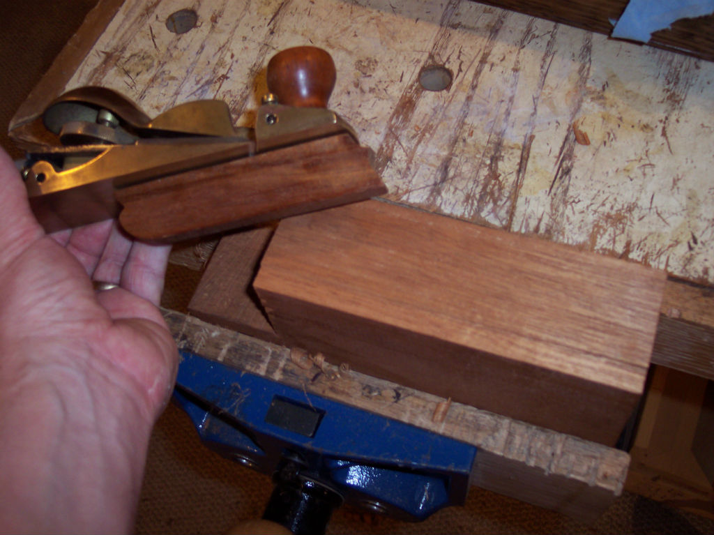

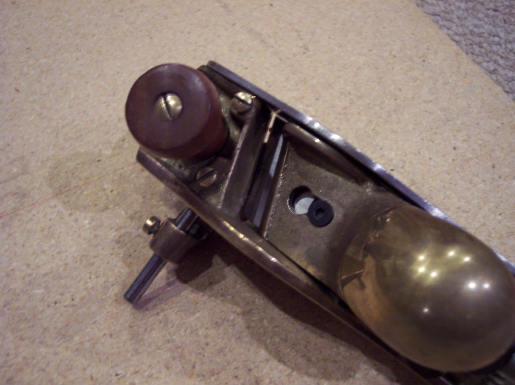

When one removes some of those screws and messes with the gadgetry, one can have a Rabbeting plane by virtue of the side of the plane being removed:
[ATTACH]25437[/ATTACH]

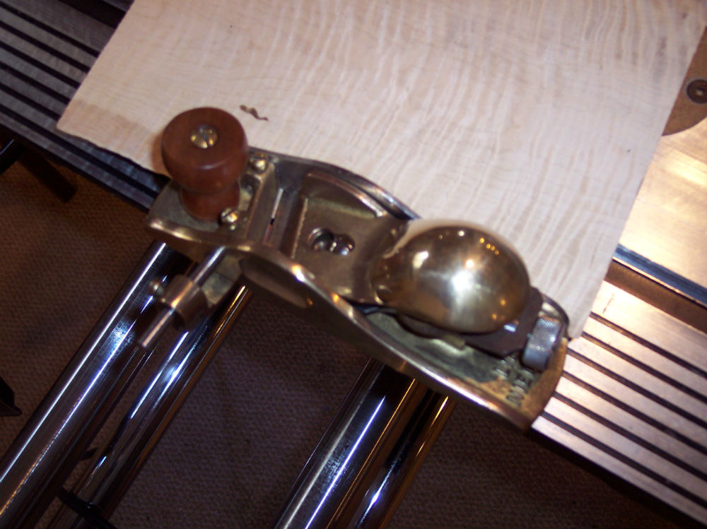

Finally, with a very sharp blade and almost everything done, a test cut is the neatest rabbet you ever saw!
[ATTACH]25436[/ATTACH]

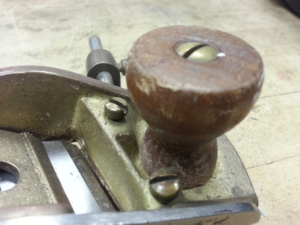

'Before' picture
Thanks for your good-humored support!
I had neglected to document my work before, but by searching a certain "flea-market bay" website, I found a picture....
[ATTACH]25452[/ATTACH]
The knob was nicked in several places, both top and bottom. I ended up shaving and replacing the bottom 1/8" of the knob with my overarm router. The upper part of the knob, I concentrated on (eccentric) wood removal and finishing.
All I have to do now is come up with a better-looking screw for the cap-holder (replacing that black-oxide one that a prior owner put in).

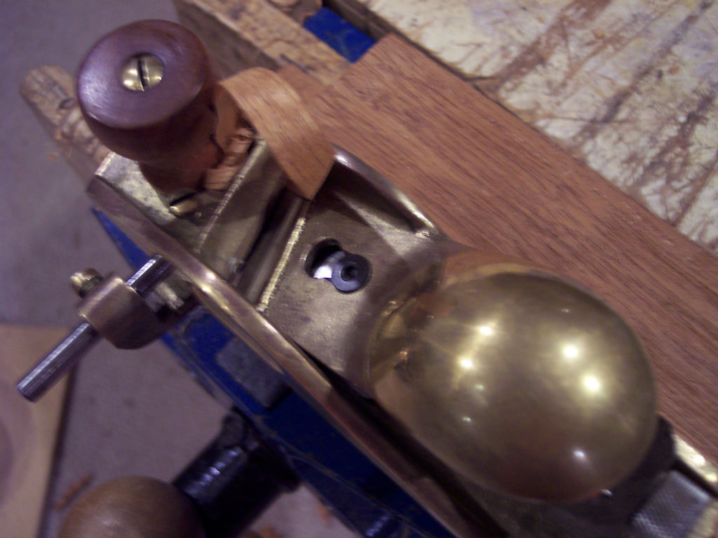

After a bit I located a nice oval-head screw for the lever-cap. I also contemplated the Bronze being not quite as shiny as I'd hoped. Plain old Brasso and elbow-grease only went so far.

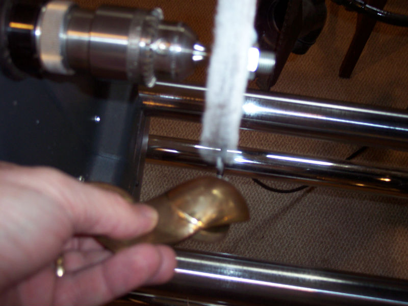

Using my Dremel buffer-tip and compound showed a lot of promise for shine-level, but it was leaving small vibration marks, like a bad router cut in wood. So, not ready to spring for a $70-plus BEALL system, I just picked up one buffer wheel and re-used my Dremel polishing compound:
[ATTACH]25522[/ATTACH]
The bigger wheel-radius did make a more uniform shine; I like it! I'll have to see about putting more buffing into my methods of work from now on:
[ATTACH]25521[/ATTACH]

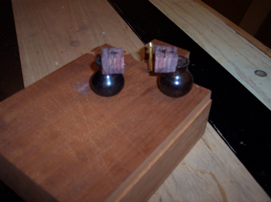

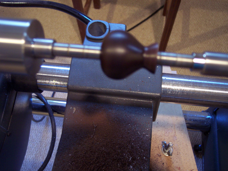

As an aside, I have several times replaced cracked/missing portions of wood knobs and re-turned them. Here is shown a crude "sled" which lets me mount knobs upside-down. Then I run them under the Overarm Router, milling off the cracked parts of their bases.
This kind of milling operation lets me glue in some replacement wood that glues to 2 different faces (vertical and horizontal) for strength. Then I can later remove excess wood and re-turn the parts for a "save."
[ATTACH]25594[/ATTACH]

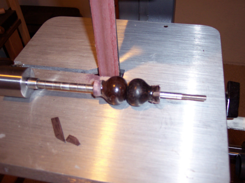

After some hand-sawing, the strip sander takes off most of the excess "patch" wood:
[ATTACH]25649[/ATTACH]

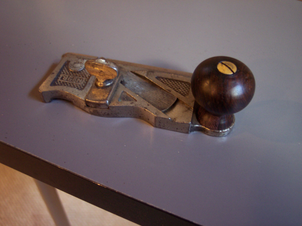

Finally, I get a repair-job done. This is a Stanley No. 98 side rabbet plane. It's the Roy-Underhill tool for the "Dusty"-type of job of increasing a dado-width by thousandths of inches at a time (anal work):
[ATTACH]25647[/ATTACH]
