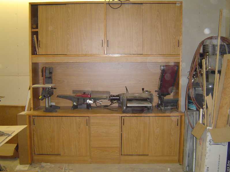

I acquired this office fixture that was part of a large "expensive" desk set. ImageIt had belonged to an apartment complex that remodeled their office. They no longer wanted this part, but kept the desk. I am guessing that this thing weighs more then 400lbs. It is made up of the upper section, (shelves with sliding doors) that sits on a bench, with two sliding door base cabinets and a center 4 drawer base cabinet.
I have arranged 3 SS 505655 mounting bases in such a way that the bench holds 4 SPT's including the planer. The upper cabinets are holding my literature and the lower ones, small tools and accessories.
I probably would not have built something so elaborate for this purpose, but I could not let this great gift go. It was actually headed for the dump when I rescued it.

This one might work,
A picture of the office fixture previosly described.
[ATTACH]1137[/ATTACH]
