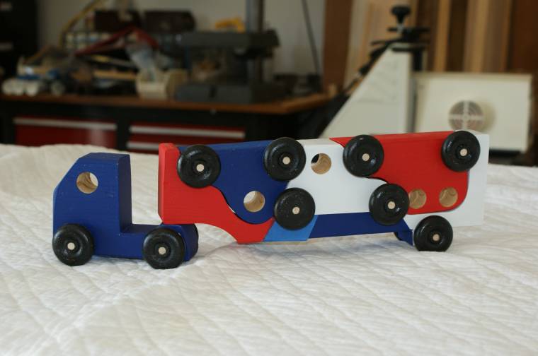

Car hauler; all cuts usin SS equipment,table saw, band saw, belt sander, strip sander and drill press.
[ATTACH]25666[/ATTACH]

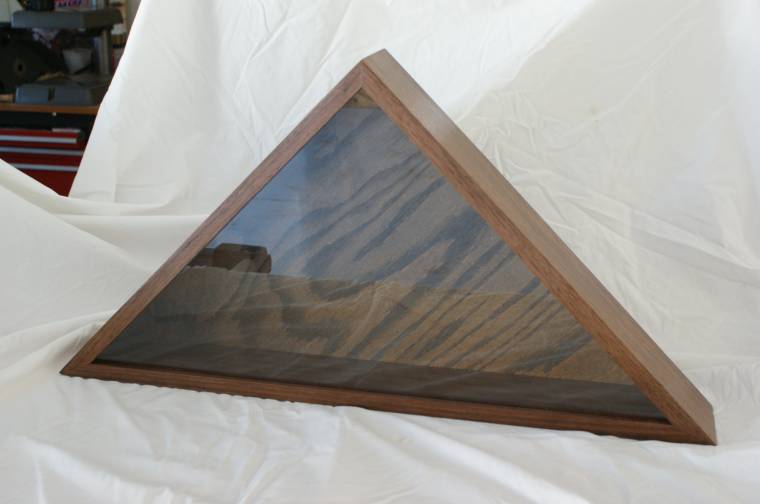

The flag case used the SS as a table saw and the glass groove was cut using a dado blade. The miters in the bottom corners were cut using a shop made sliding fixture

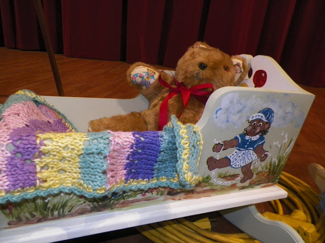

Cradles used table saw, band saw, 6X48 belt sander, strip sander a non SS router table (home made).

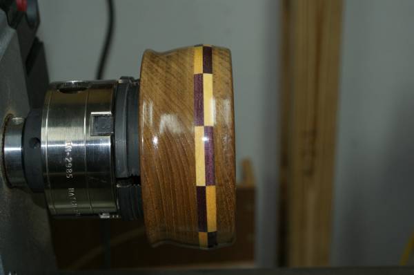

Bowls were made using the SS lathe function as well as the band saw for rough shaping and used the speed reducer to get the RPM down to about 35 for finishing. The yellow and purple heart segments were cut using a custom sled ( home made) on the SS table saw.
[ATTACH]25670[/ATTACH]

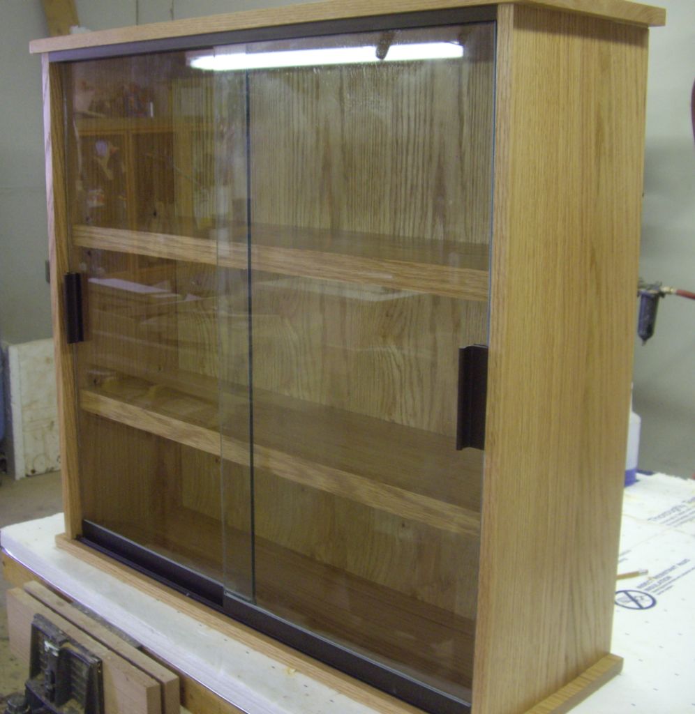

Trophy Cabinet
SS used for rips and cross cuts.

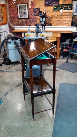

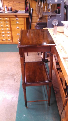

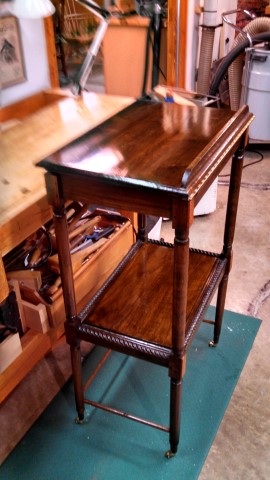

I recently posted these, but here we go again. The mortice and tenons, dados, shaping, biscuit joining, jointing, planing were all done on my SS. I have a dedicated table saw for ripping, and radial arm for cross cutting. Spindle turings were done on the SS, although some of the decorative turnings were done on my Rockwell Delta lathe.
[ATTACH]25672[/ATTACH]
[ATTACH]25673[/ATTACH]
[ATTACH]25674[/ATTACH]
It's a music/bible stand for our church.

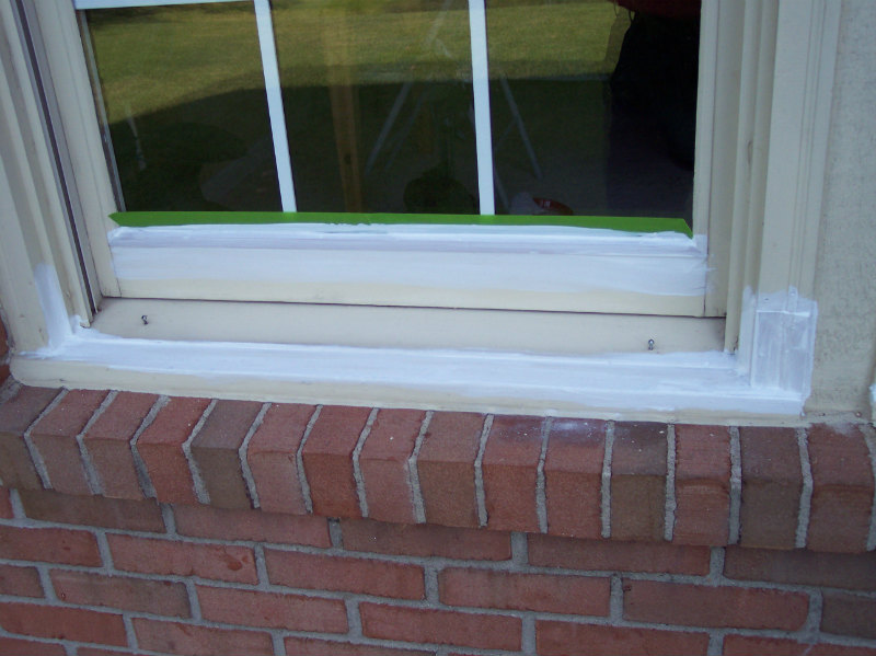

Saturday I decided to replace a couple of warped/rotted window trim pieces. I never left the house for lumber. Just used some old redwood and cedar lumber that I dumpster-dove years ago. Shopsmith jointer and bandsaw were used for basic dimensions and bevel-cuts. On-site, I used the LN140 skew block plane (in my avatar) for various fine-tunes. Now the new wood is primed and I'll paint it later today.
[ATTACH]25676[/ATTACH]
