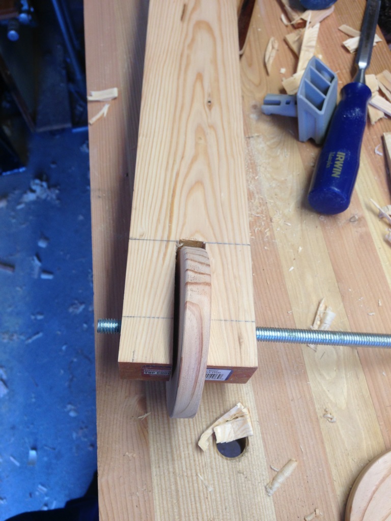

And for 1/4" stock regular taps and dies with the coarse threads should do the job just fine. 1/4" x 20, 5/16" x 18, 3/8" x 16, etc.
I just tapped these in a piece of pine. 3/8 x 16
[ATTACH]25677[/ATTACH]
2014-07-18 07.54.04-sm.jpg (191.23 KiB) Viewed 5691 times
