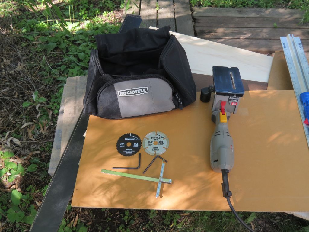

I'm a guy who likes to store his tools in boxes, well this one comes with a bag and it works. Plenty of room inside which is also nice.
This is about what you get, well minus the paper work.

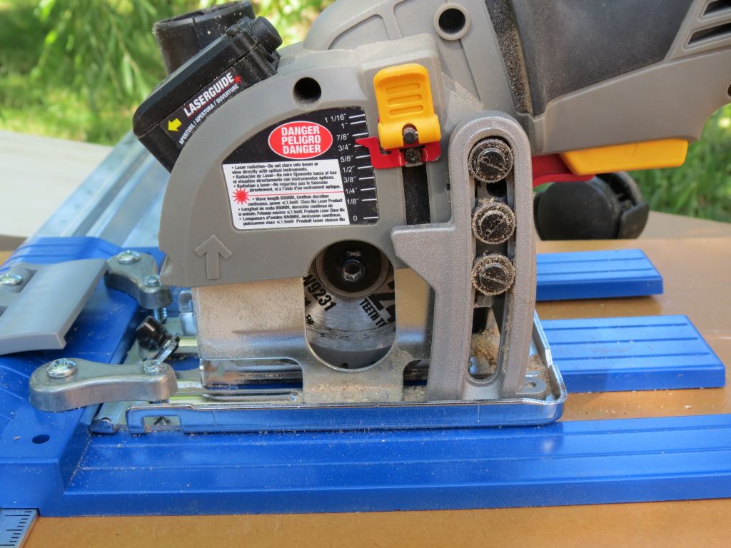

This side view shows the depth stop, I was cutting 1/2" plywood today, I take off the plastic sole off the saw and have to accommodate for the thickness of the jig. It will just cut 3/4" this way, so we are at the extend of its dept with the thicker plywood.

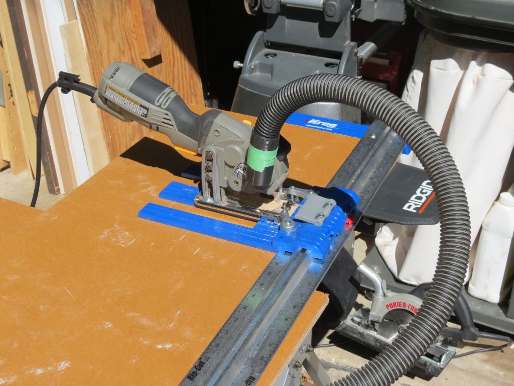

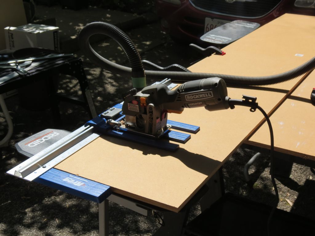

Once I made friends with it and went to the smaller saw it has worked out very well. Today's project was to cut up some plywood, 16" wide and 61" long. I did the "rip" cut first then set up to do the cut off. The next two pictures show this.

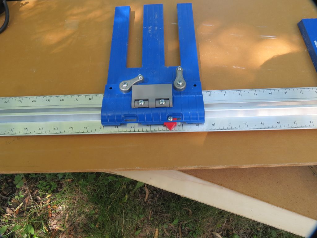

You can adjust the pointer so it is at the kerf, either in the middle or to the right or left side of the cut. Once set you then just flip a lever and slide to the dimension you want. It is labeled in 1/16", it is easy enough to find the half way point between markings but you are getting to the point that accuracy of a 1/32" might be more a bit of luck then skill. I still go for it but then that is me.

Attaching and setting up is fast and easy enough that I take it down after use at the end of the day rather then trying to keep it together because it is so easy to do.
