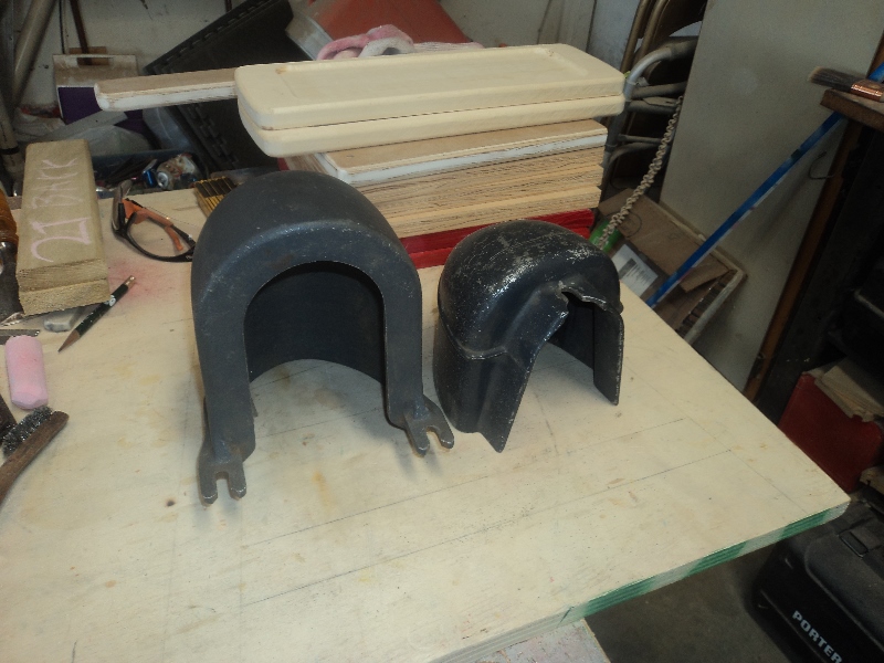

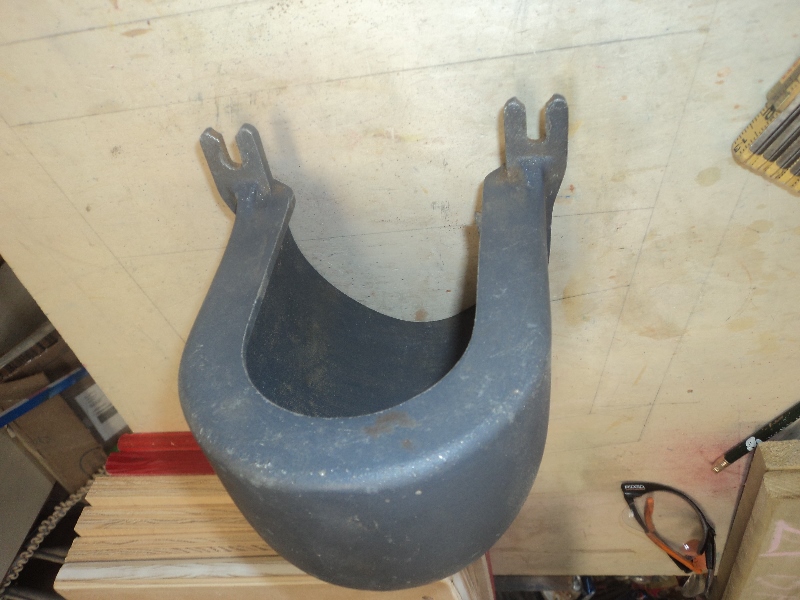

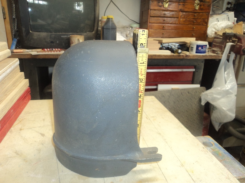

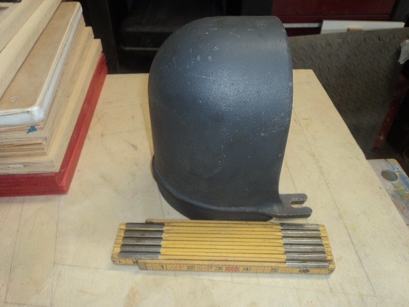

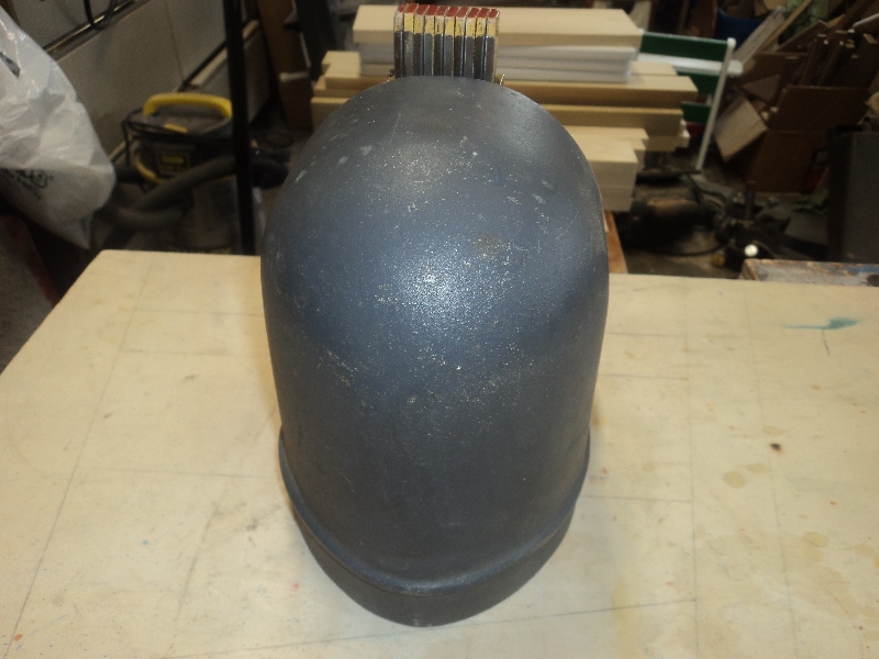

I just bought a 2nd 10Er and among the parts was a cover that I don't recognize. I added some pictures and several include a 10ER pulley cover for reference. Can someone help?

A lower pulley guard???
I have never seen one but think they have been mentioned
(might have been something other than a 10ER).
I see nothing resembling that in time relevant catalogs.
So, I think it is not a 10ER part,

Of course. I be curious about it also.e.friedl wrote:That's kind of what I thought. Perhaps a drill press. But I'll just wait and see if one of the others has knowledge.
It looks like a pulley guard and you might have a rarity. You might check to see if the bolt flanges on the guard line up with the bolt slots on the 10ER motor mounting bracket.e.friedl wrote:I just bought a 2nd 10Er and among the parts was a cover that I don't recognize. I added some pictures and several include a 10ER pulley cover for reference. Can someone help?

I think Rob and Ed have it. However, that is just a guess.

I tried out the "lower guard". It fits perfectly to the motor mount bracket. I guess I really lucked out. For a hundred I got a decent 10ER with a good variable speed unit, a jig saw (will need a lot of TLC), the joiner/sander table insert along with a joiner head and a front of table miter extension. Oh, yeah the steel bench ends with casters, and hold on to your hats, the table top is two finished S4S 8/4 oak planks.
I'll post some pictures of the guard tonight when I get a chance. I mounted the lower guard to my other 10ER as I tore the new one down completely for an overhaul.

Great to hear! I was hoping you might have gotten lucky. I have never seen the lower pulley guard nor the lower saw guard in the flesh. Congratulations.e.friedl wrote:I tried out the "lower guard". It fits perfectly to the motor mount bracket. I guess I really lucked out. For a hundred I got a decent 10ER with a good variable speed unit, a jig saw (will need a lot of TLC), the joiner/sander table insert along with a joiner head and a front of table miter extension. Oh, yeah the steel bench ends with casters, and hold on to your hats, the table top is two finished S4S 8/4 oak planks.
