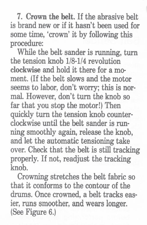

Post by STB »
SDSSmith wrote:Did you crown the belt?
What does "crown the belt" mean? :confused:
Glenn
SDSSmith
Posts: 1940
Location: San Diego, CA
Post by SDSSmith »
Stumpbuster wrote:What does "crown the belt" mean? :confused:
From the manual.....
[ATTACH]25765[/ATTACH]
