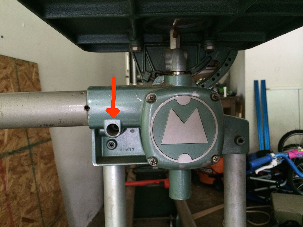

I have an old 1955 Jigsaw, but I'm missing the bolt that locks the tube arm to the base. Can someone post pictures / description of that part, please? I have attached a photo with an arrow to point to the missing part. Thanks!

I'm sorry to tell you that what you are missing is more than just a "bolt." It is an assembly of parts to clamp the round arm to the base. And the really bad news is that it is not stocked by Shopsmith (I know, I checked when I needed one). My solution is to make up my own based on the following diagram from the parts manual:
[ATTACH]25863[/ATTACH]
The "clamp parts" I made from nylon bushings.
I have also attached a full copy of the manual for your reference.

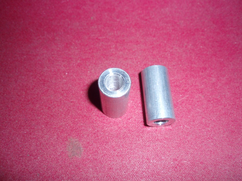

Joe, what is the OD of the wedges that joefitz needs? When the wedges come together, what is their over all length?

Thank you both for the info. This helps a lot! I actually contacted Bill Mayo via email before I posted this - waiting for a reply. Good idea about using a nylon bushing - I should be able to do something like that.

1/2" od x 1 1/4". Two pieces equal length, 1/4" clearance hole through one and 1/4-20 threads through the other. Flat clears the arm od. Bevel provides clamp. Similar to carriage and headstock locks, but smaller.
Be patient re response from Bill.
Repeat in a week if no response.

joe and joe, I asked because I thought I might have some parts that could be used to fabricate the missing parts. These have an OD of 1/2", an ID of 1/4" and are 1" long. They are aluminum. If they might help, let me know.
[ATTACH]25865[/ATTACH]
Jig Saw Bushings 003 (Custom).jpg (192.16 KiB) Viewed 4392 times

This has been so helpful - thank you all. Thanks for your offer, Dusty! I'll see if I can rig something up myself before putting you out.
