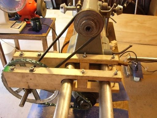

My ? is!!!!!!!! DRUM ROLL!!!!!!!!!!!!I have 2 Ers, 1 I would like to dedicate 1 as a drill press, in the summer shop, and the other for a turning lathe in the basement. I can handle the cold to go to the summer shop in the winter for a bit to use the machines out there if needed. I have 1 ER speed changer, and need the slower RPM of that on one of them, my thought is, put that on the drill press, and WHEN I get into lathe work, in the basement shop, drop the $300.00 for the Leeson DC motor and controls for the basement ER didicated lathe.
Also to save summer garage space, not cut the ER dedicated drill press, but shorten the support base, move the tube supports forward on the shortened base, encase ever going to horizontal, and the tubes would rest on it , between motor and table, instead of the end.
Whada ya think about that???

RPD, Ya that is what I am talking sorta!!! Watched it B4, some one here sent it to me but was not thinking that yet! Thanks. He mentioned a "jack shaft", also that term came up in a different You tube, what is it?

Tie bar, no, HEAD REST!!!! Move that to a midpoint of, the HS, as in the video, but I would prefer it fixed, not a floater like in the video.
rbursek wrote:RPD, Ya that is what I am talking sorta!!! Watched it B4, some one here sent it to me but was not thinking that yet! Thanks. He mentioned a "jack shaft", also that term came up in a different You tube, what is it?
A jack shaft is a shaft with two or more pulleys that is mounted between the motor and the upper shaft. (like the speed changer)
To enable the use of larger pulleys, (greater change in speed), it is usually mounted behind the way tubes.
To help visualize what I mean this is a photo posted by spot_dawa in the Yahoo Shopsmith10ERusers group photos section in the album Slow speed jackshaft - 10E. (you will need to be a member of that group for the link to work)
[ATTACH]25871[/ATTACH]
There used to be another album in that section that showed a 10ER base that could be expanded or contracted, (like a dining room table when you add leafs). I am having difficulty locating it right now but will post a link if i find it later.
