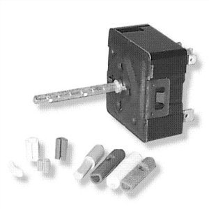

I wasn't too impressed with the 'universal' replacement they sold me last time; it allows some flimsy plastic tips to be placed on the shaft once it's sawn to length. The applicable plastic tip is what broke on me lately:
[ATTACH]25896[/ATTACH]

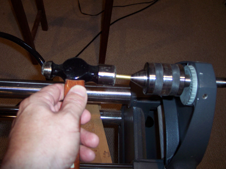

I 'flared' a short piece of brass tubing to fit just around the remaining metal shaft:
[ATTACH]25898[/ATTACH]

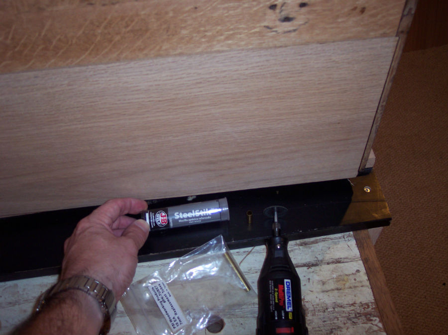

At one end of the brass tube, I made the "half moon" cut with a Dremel cutoff wheel. Yes, that's another machinist-chest being restored in the background:
[ATTACH]25897[/ATTACH]

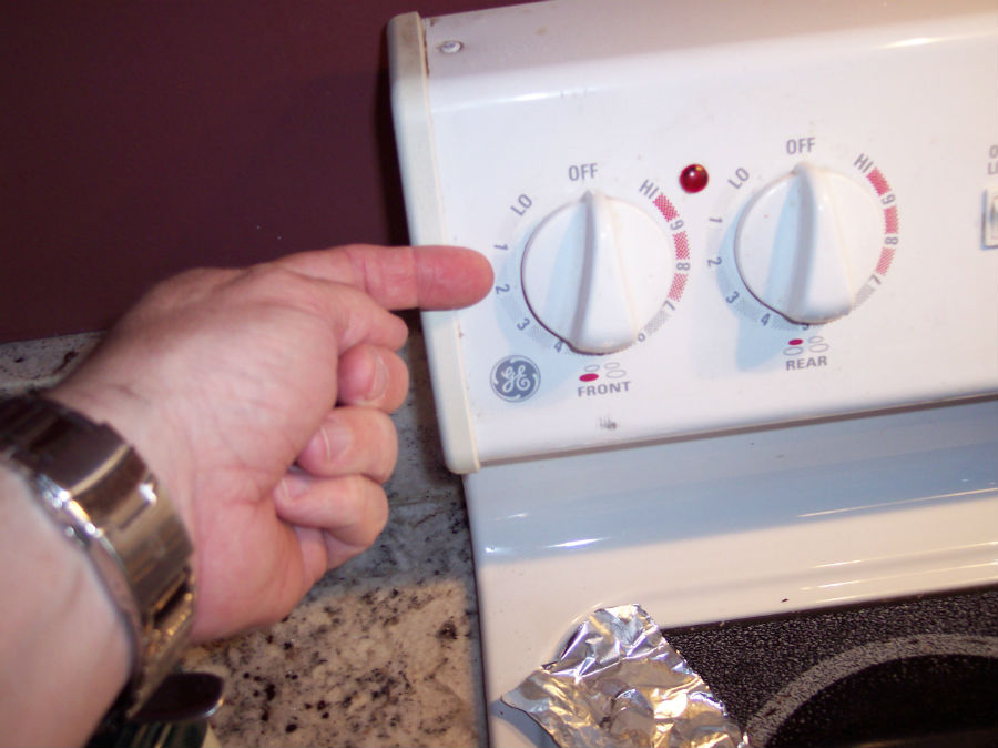

Using the JB Weld stick-epoxy, I filled the brass shaft / half-moon, and put everything together within 5 minutes. After drying, it works as well as the rest of the controls :) :
[ATTACH]25899[/ATTACH]
Cheapo New Control.jpg (11.97 KiB) Viewed 665 times
Shaft Filler.jpg (93.75 KiB) Viewed 667 times
Tube Flaring Mandrel.jpg (91.67 KiB) Viewed 670 times
Knob Refitted.jpg (80.61 KiB) Viewed 667 times
