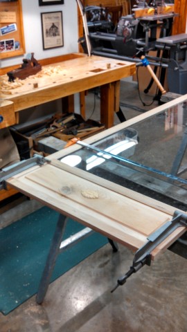

The storm door on my machine shed, which I made in 2003, had some joint problems at the top and bottom coping. I was going to repair them, but ended-up making a whole new door. It's made out of recycled wood. Pine in the panel, birch for the frame. All the wood had 40 yrs + age. They were SS jointed and run through the SS planer, then coped with the SS shaper. Here it is dry fitted after all parts where shaped.
[ATTACH]25956[/ATTACH]

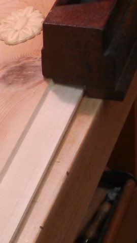

The floating panel was hand cut with a panel raising plane. The plane was made by James Moir of Glasgow, Scotland in 1836. It has a skew blade and cuts beautifully.

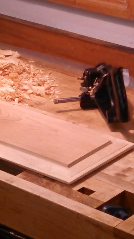

I used a Stanley #289 skew rabbit plane to bring front and back of the panel to just under 1/4" and a depth of 3/8" to sit in the coping.

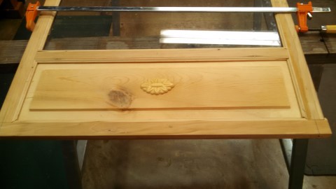

Here is the panel dry fitted. I attached a medallion - feeling artistic! :D

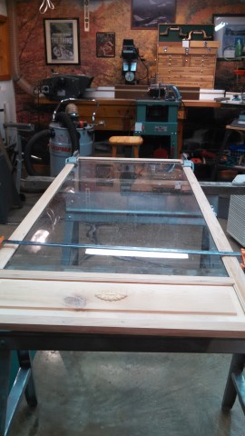

Glue-up.
