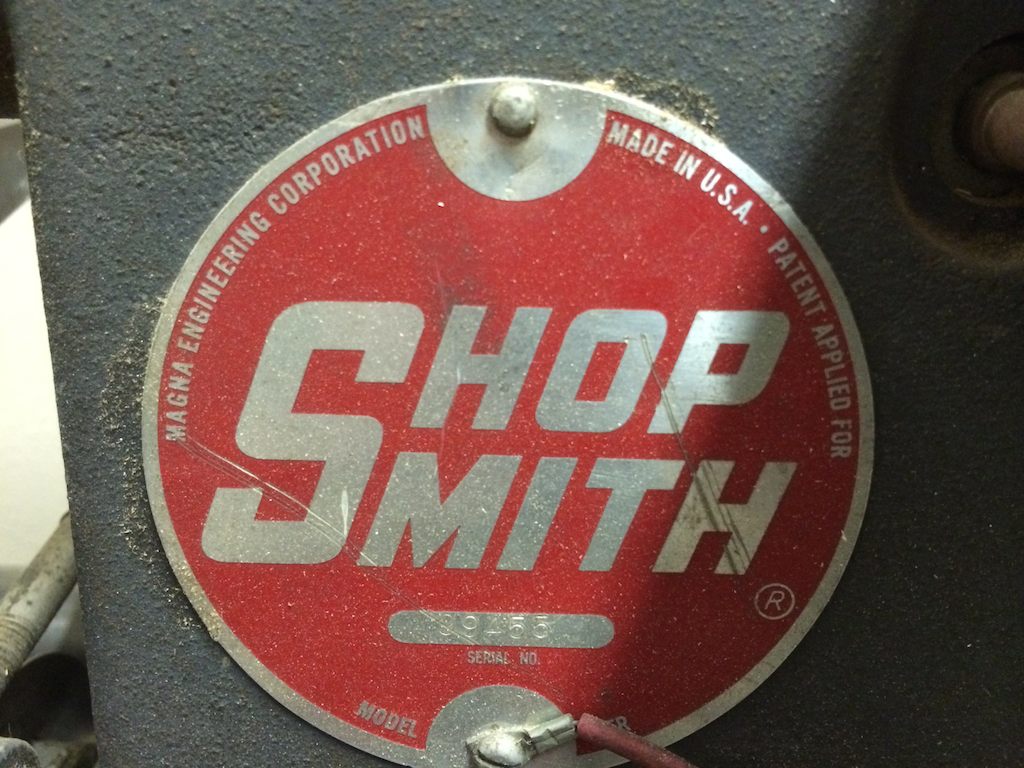

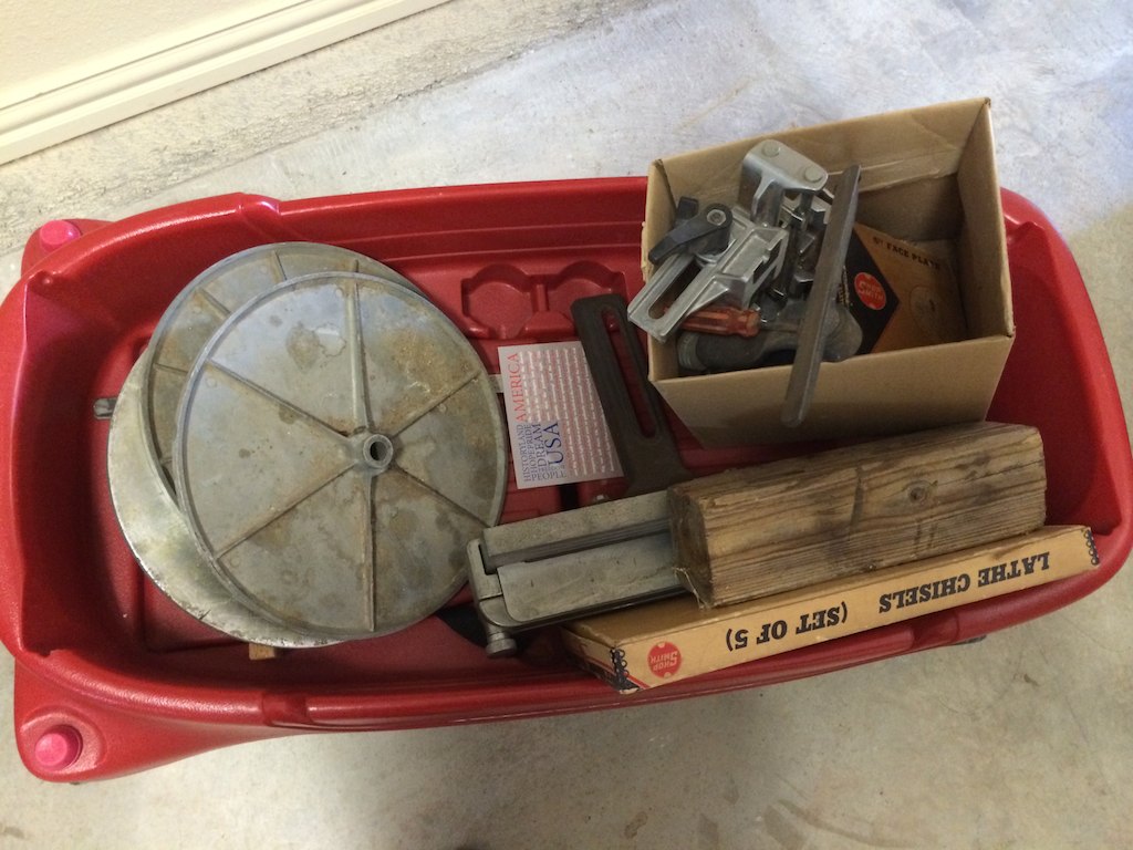

Gents, I am now the owner of a Shopsmith 10ER. It was my wife's Grandfathers, passed to her father and just recently when my father in law passed away no one wanted anything to do with it. I jumped at the opportunity to pick it up because I have always wanted to learn to work with wood. Now that I have this new toy at home I don't even know where to begin. Im going to take my time and clean it up real good and then slowly try to learn the machines in's and out's. Please take a look at some of my pics and give me feed back.

You done good!
You now have a fairly rare animal. 4E jointer etc, a speed changer, 3 disk sanding plates and IIUC, a ring-master!!!!
I did not notice a drill chuck, but that is easily 'fixed'.
A word of warning, do not allow the springs on the speed changer to become fully compressed EVER! They are on the control shaft at the fixed arm location.
Saw blades???

Only came with the one rusty blade. Are these not standard size blades I can pick up anywhere? I have a chuck. I'll grab some pics tomorrow. I need to get it all scrubbed up and lubed down.

IIUC = IF I UNDERSTAND CORRECTLY
A RING MASTER IS A DEVICE THAT ALLOWS ONE TO MAKE 'BOWLS'.'VASES' FROM FLAT BOARDS.
The saw blades are standard with a 5/8" arbor. Be aware that the 10 is an 8 inch design.

I missed the most important question.
The springs do not break. The ears on the fixed pivot or the movable one do break. An all too common occurrence. If the springs do not get fully compressed when making speed adjustments, the ears will not break.
So the purpose of the springs is to make sure excessive force is not applied to the ears. The 'secret is to make speed adjustments slowly so the movable sheave has time to respond. The 10 differs from the later models in that damage can occur when adjusting either towards fast or slow.

Let me help, if possible.
Adjusting the settings on the speedchanger, ONLY do it with the belts turning. Either put one of your 3 (lucky you) sanding discs on, and turn by hand, or just plug it in and run it. Like JPG said, do NOT do it with nothing turning, and do it slowly, until you get a feel for it.
Saw blades. Any 8 inch, or even 7 1/4th inch blades will work, but you can cut deeper with an 8 inch blade. 5/8ths inch hole, to line up with your 5/8ths arbor.
Treat it well. It has lasted a LOT longer than anyone else's Mark whatever. (And, is {in my humble opinion} built better. You can build a Mark whatever with a Model 10. (Shopsmith is STILL using Model 10s on the production floor.) Try building a Model 10 with a Mark X.
Oh, enjoy your new hernia. That thing is HEAVY!:D
