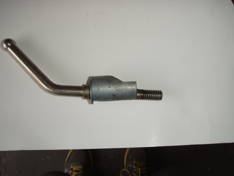

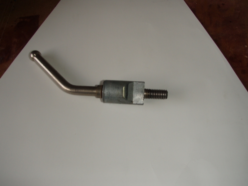

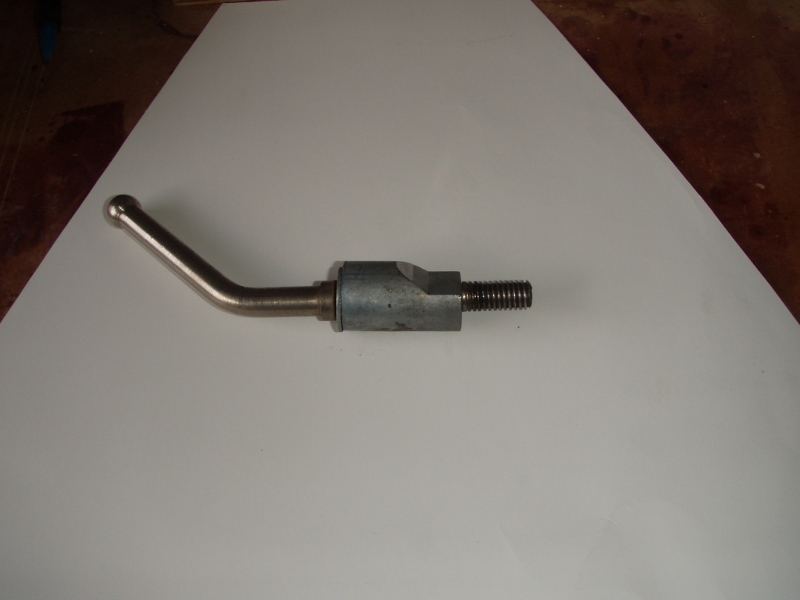

All of my Ers carriage and HS locks look the same, but on the dedicated DP the table will move unless REALLY Gorriladed!!!
They all have a shiny area, with a slight radius to them, I dont know if from wear or by design, and if that is the problem ?
It shows up the best in the first pic.
Hencle, God save the Queen!!!

Bob, I've got 2 suggestions.
#1, switch them around, and see if the loose one moves. (Put the carriage one in the headstock or quill position, and see if the quill or headstock has issues locking down.
#2, remove the screw, and sand down the front end, to see if you're bottoming out in the hole. (Or, look at the front end, and see if they have been hitting the bottom of the hole,)

L am not familiar with the single wedges. Does the 'screw' mate to a threaded hole in the headstock?
If so, like Skou said, make sure it is not bottoming out in the bore.
That shiny area is minimal wear.
On Mx we file it flat matching the original angle. That may create bottoming out with this one. Measure bore depth and wedge length.
I assume the wedge bolt hole is not tapped.

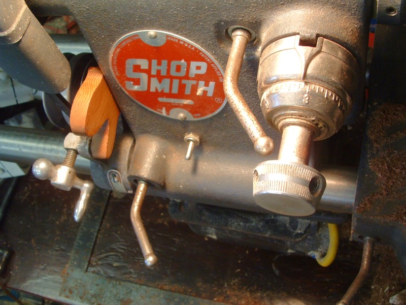

I thought that too,
[ATTACH]26130[/ATTACH]
One of mine has double wedges and the other has the newer single wedge locks. I prefer the single wedge design myself.
- Quill lock.JPG (127.24 KiB) Viewed 2343 times
Those must be an ER thing.
My E has through bores with two piece wedges and the inner wedge holds a captive nut(hex shaped hole).
The earlier of my ER's has the same, a PITA to remove/reinstall. The later one wedge design just screws out, no hassle." wrote:Those must be an ER thing.
The modus operandi changes also. The two piece squeezes the way tube between the two line contact wedges. The one piece squeezes the line contact wedge on one side, and the whole side of the way tube bore against the opposite side. I guess the one wedge design would work better(assuming all those things mentioned earlier are not present).rpd wrote:The earlier of my ER's has the same, a PITA to remove/reinstall. The later one wedge design just screws out, no hassle.
