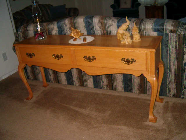

My very first project with my new Mark V was a couch table with Queen Anne or Cabriole legs. I still don't think I have the skills, 10 years later, to try turning identical legs! I used the band saw to cut out the legs. First sawing one side, taping the cutoffs back on to the piece and sawing the second side. This is done using the same procedure that Nick showed (Sawdust Sessions) for sawing out the reindeer! The method may also be in PTWFE. In my case the legs extend from the table top to the floor. There is a seperate piece that fits between the leg and the aprons. It was doweled to the leg and then shaped.
[ATTACH]1148[/ATTACH]
The bandsaw method is a lot simpler for me than turning. After bandsawing, all you need is a rasp and some sandpaper. The bandsaw is only about $40 more than the lathe duplicator, but much more useful.

Chuck's table
Chuck,
Awesome table with great legs! This befits the forum's need for more photos too....
Tell us a little more on the top of that table too!
Chris

I have been watching this string with interest since I have some cabriolet legs to make.
I was expecting someone to chime in with the difference between turned legs and band saw cut legs. It has always seemed to me that the turned legs are not as "pronounced" and don't have the same graceful curves. I've thought of turned legs as faux cabriolet legs.
Is this correct? Has anyone actually turned legs that look as graceful as the ones Charles did? With all due respect to Nick, turning the legs is a great idea and would work on some projects, but his aren't nearly as nice as Charles'.
