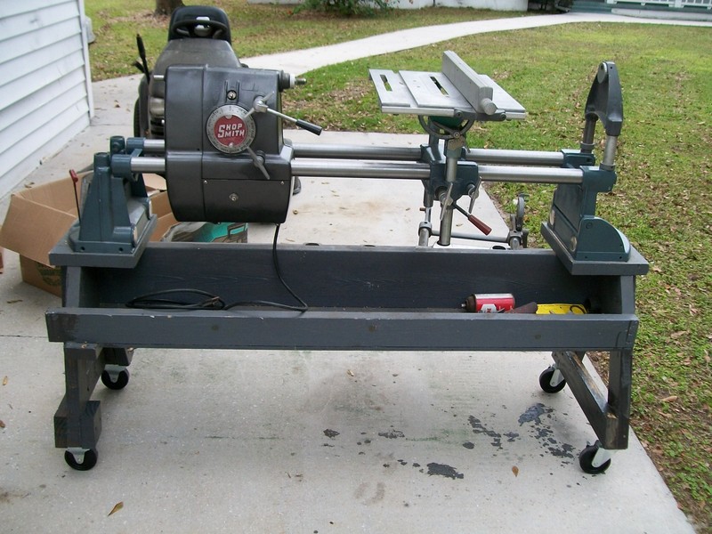

10 ER, stripped down.
I converted my construction Shopsmith, on 10" wheels & tow bar, over to 4" casters. You can make the height to whatever you find comfortable to work at. This one is about the same as the regular Shopsmith.

That is too cool!billmayo wrote:I converted my construction Shopsmith, on 10" wheels & tow bar, over to 4" casters. You can make the height to whatever you find comfortable to work at. This one is about the same as the regular Shopsmith.

The picture that billmayo posted says a lot about our Shopsmith. At this time I do not feel the need to lower mine, but if I wanted to , I think the picture says it all. do what you need to use your machine. I saved the picture for future reference. thanks
