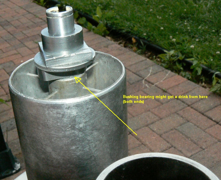

Oiling belt sander idler drum bushing bearings
trainguytom wrote:JPG, I did not get into the drum and, from the looks of it, I don't think I want to, but since you have, do you recall if the bearings are they close enough to the ends so that I might drop some light oil into the ends in hopes of getting some in to soften the old grease.
I think this is accessible from the end. The oil would have to migrate to the bushing though.
[ATTACH]26500[/ATTACH]
I just looked at the exploded view in the manual. The large washer I believe is supposed to be between the drum and the guide bushing. In this pix they are reversed!!! Gotta check that out!!!:o
