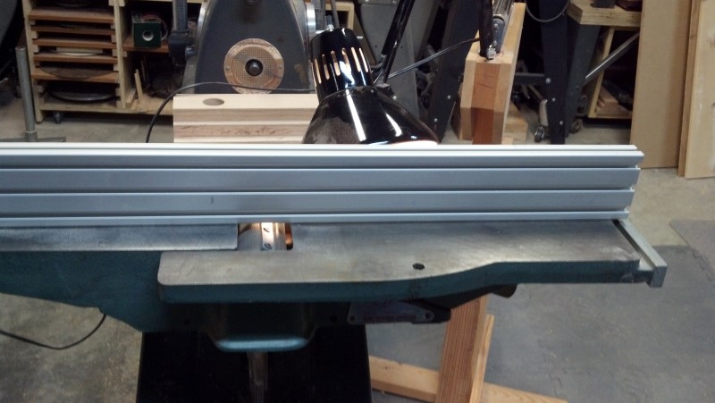

If you lay a reliable straight edge across both the infeed and outfeed tables at several different locations, do the tables appear to be co-planar. Are the tables adjusted to be the same height (zero depth of cut) as the cutter at the top of its arc.

I used a piece of 80/20 that is as straight as anything I have in the shop.

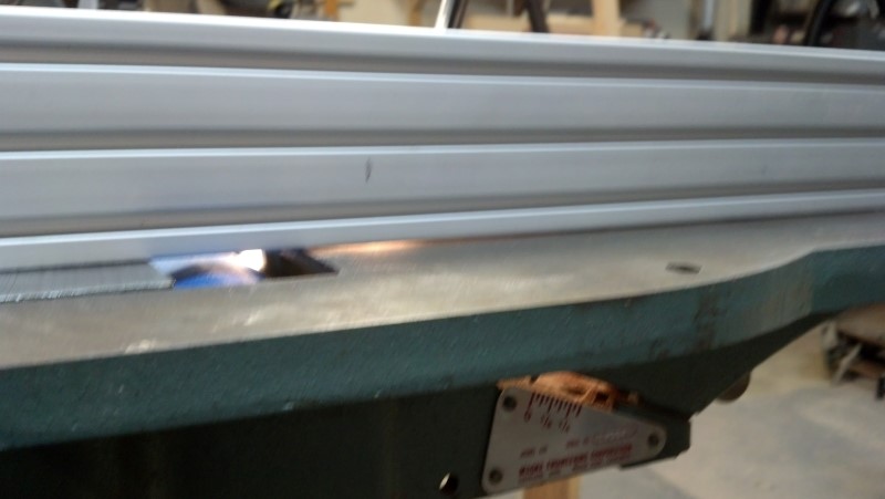

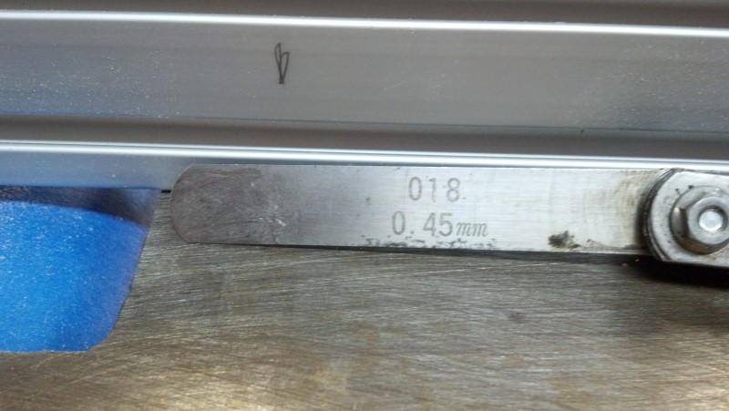

With the outfeed table as the reference, I raised the infeed table until the front edge touches and there is no light at 1st contact.
[ATTACH]26618[/ATTACH]
That gap was 018

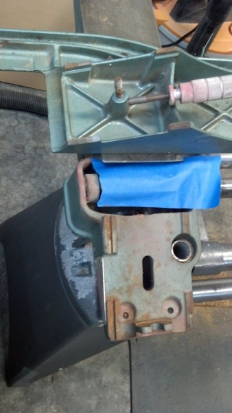

I disassembled the joiner and found the bosses lightly rusty and coated with dirt.

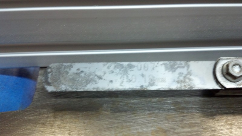

I cleaned them up with a brass brush wheel on my hand drill until they were polished clean and got a gap of 007.
[ATTACH]26620[/ATTACH]
I don't know if that's considered within tolerances but I was surprised by the difference.
That gap was 018
