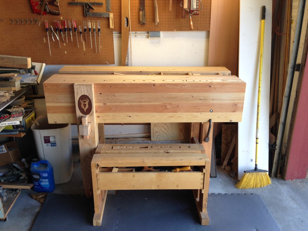

I finally put the finishing touches on this English Joiner's style workbench.
[ATTACH]26657[/ATTACH]

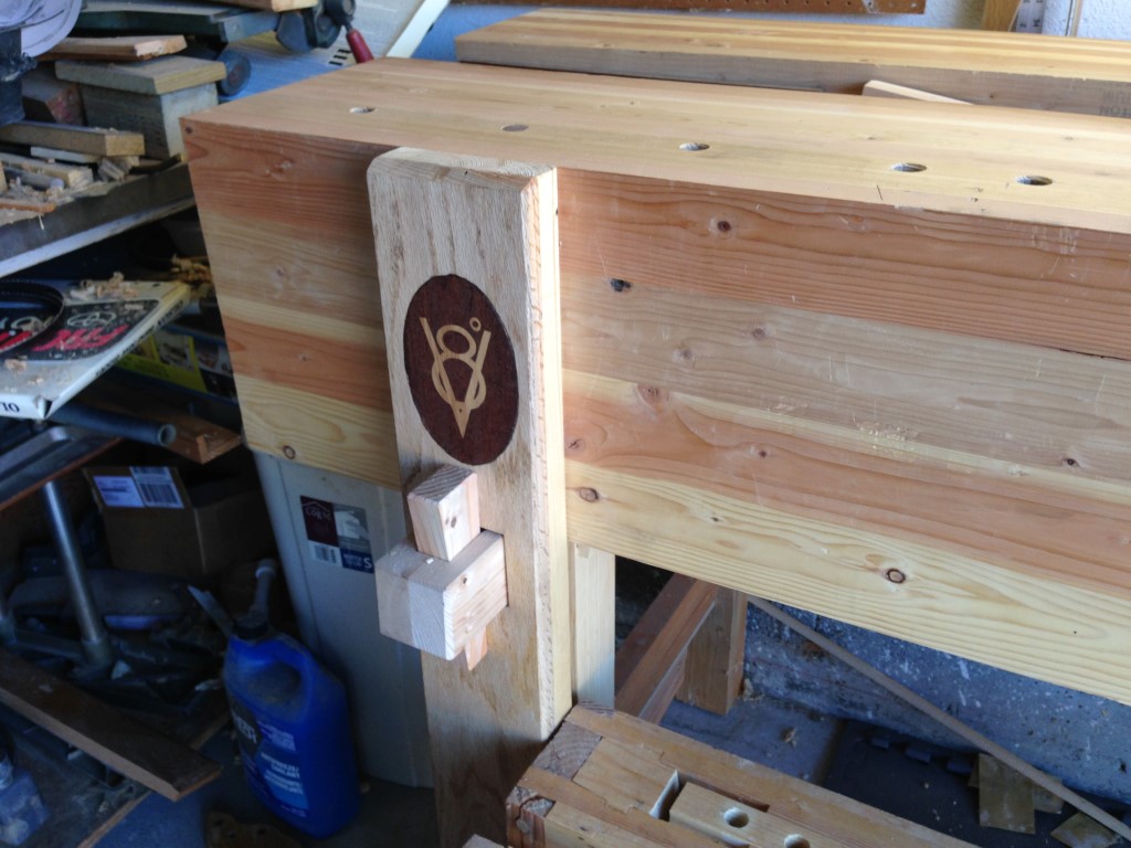

This is my version of the Paul Seller’s Joiner’s bench. With V8 degree powered leg vise and wagon vise inspired by Paul Miller (AKA Shipwright).
Material: Fir and hemlock? from Big Box store (Both orange and blue) 2×4s and other scrap/scrounges. The front of the leg vise has a 3/4 inch oak plank laminated to it.
Dimensions: 60 inches long x 30 inches deep X 39 inches tall. (I went with a taller bench for 2 reasons, I’m kinda tall at 6’2” and the kind of work I do is more suited to a taller bench). This bench puts my work at the very top of the “Power Zone” and the lower end of the “detail zone”. I have used this bench quite a bit before calling it “Done” and I’m quite happy with the height.

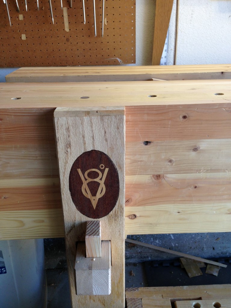

Shipwright was kind of to provide me with the inlay for the leg vise and installing this was enough for me to call this project done.
[ATTACH]26658[/ATTACH]

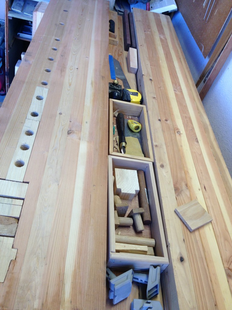

Tool well with boxes to hold dogs and wedges and other bench items.
[ATTACH]26659[/ATTACH]

Shop all cleaned for the evening.
[ATTACH]26661[/ATTACH]
