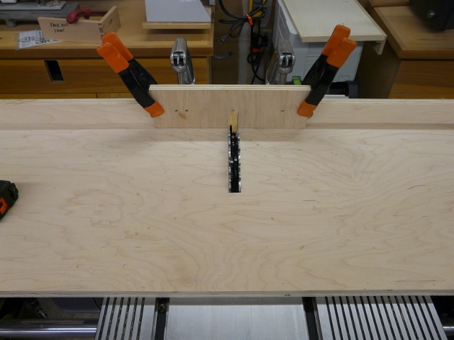

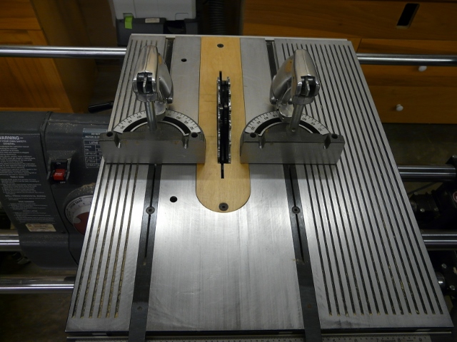

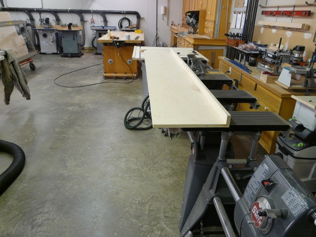

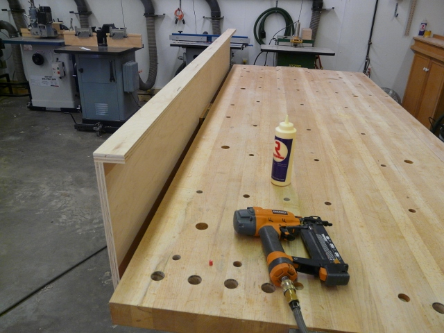

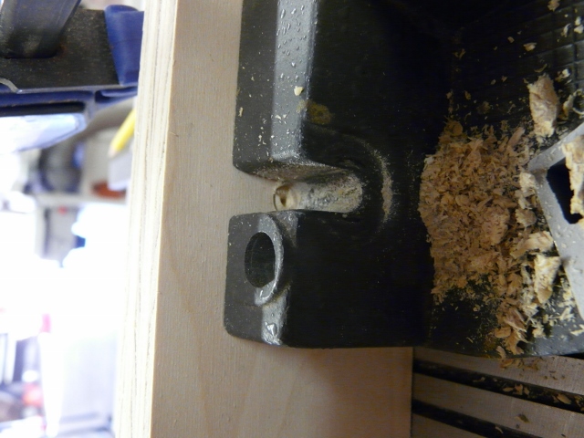

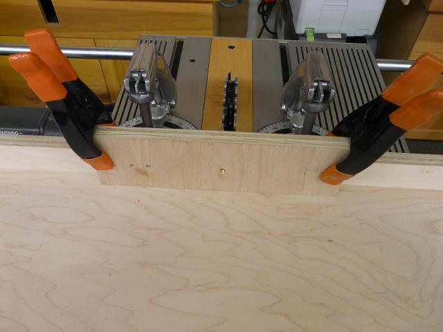

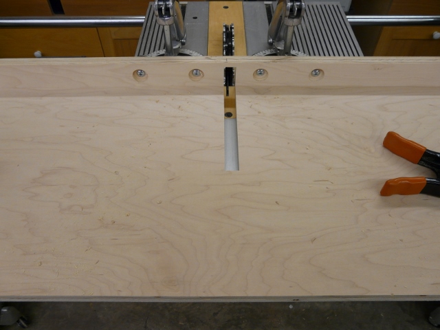

First step is to build a jig.
[ATTACH]26820[/ATTACH]
[ATTACH]26821[/ATTACH]
[ATTACH]26822[/ATTACH]
[ATTACH]26823[/ATTACH]
[ATTACH]26824[/ATTACH]

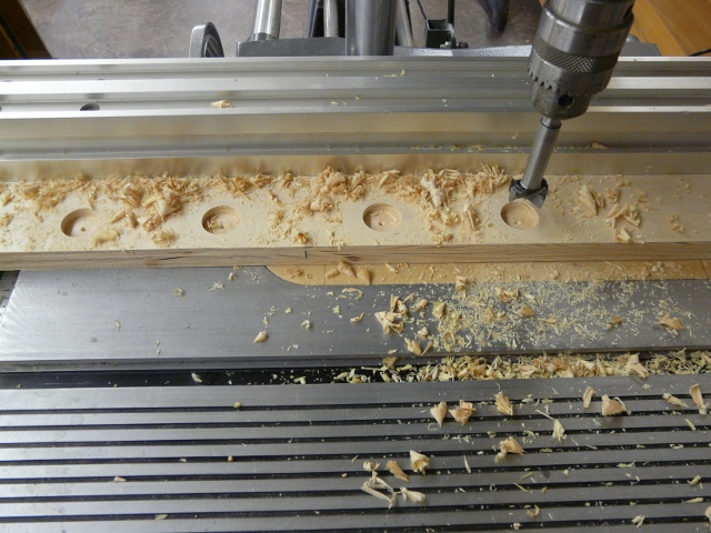

[attach]26826[/attach]
[attach]26827[/attach]
[attach]26828[/attach]
[attach]26829[/attach]
[attach]26830[/attach]

You've sure built the suspense -- what is the cut you're doing?

It's a "MB Super Wide Reverse Dado Sled" :D

That is one long dado sled!

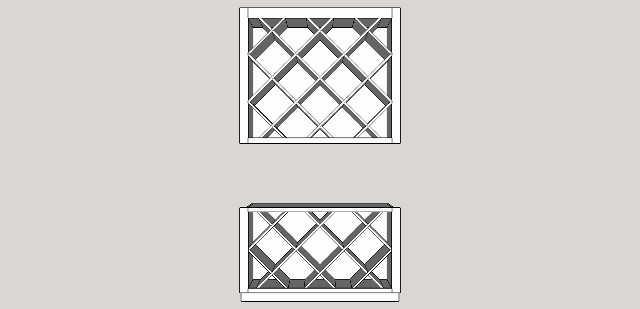

[ATTACH]26860[/ATTACH]
I have started with a Sketchup drawing of my project.
[ATTACH]26861[/ATTACH]

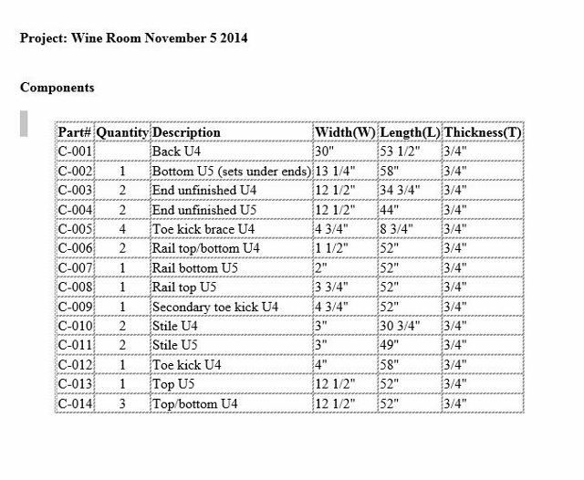

And a partial cut list. Ill print out the wine lattice parts a little later.

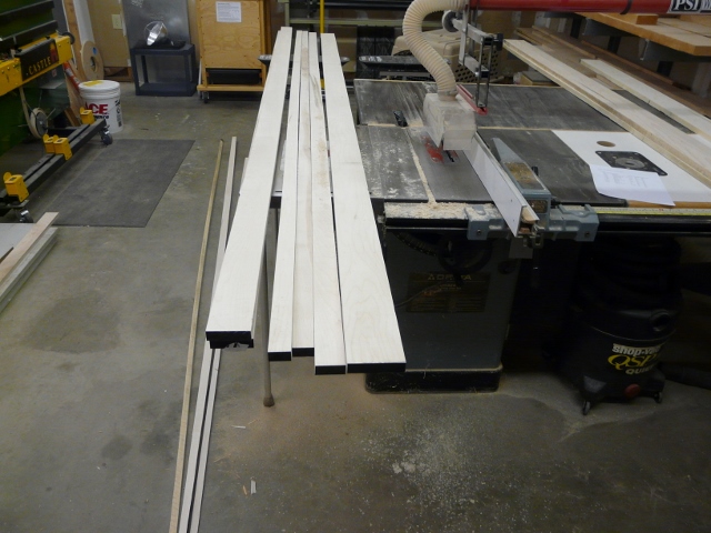

For now we will be working on the face frames. I like to rip first and ask questions later.;)

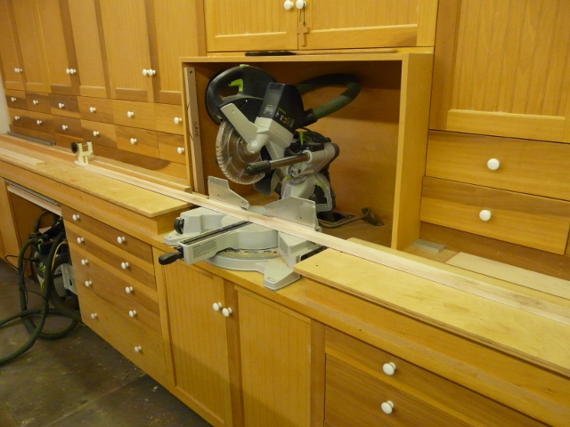

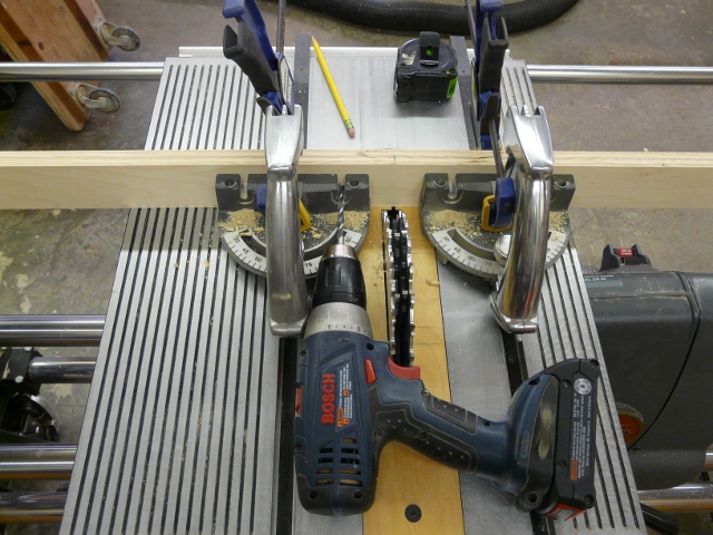

[ATTACH]26863[/ATTACH]
Cutting parts to length.
[ATTACH]26864[/ATTACH]

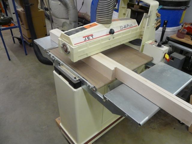

I like to sand the saw marks out on the drum sander. Then I will sand the best face side.
