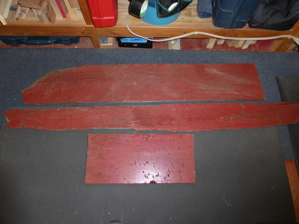

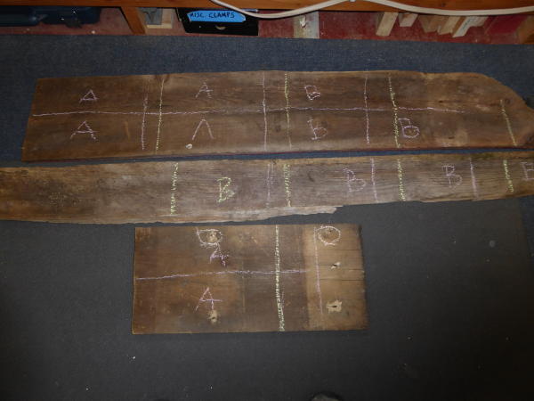

I took a project and its different than anything I've done before thus I'm looking for thoughts and suggestions about how to proceed.
My customer lost her grandparents who were farmers. In the settlement of their estate the property went on the auction block and the buyer choose to tear down the house and barn. As a last minute thought she decided she'd 'salvage' some barn pieces for a memento. She asked me to make 3 - 5 x 7 picture frames from this - one for her and one each for her two siblings.
I've made my share of picture frames but they were always with nice stock, straight with parallel edges. Even if it was re-purposed it's been good stock.
As you can see I've begun to layout how I can get the pieces I need. To be successful I need to keep as much of the "natural" edge as I can. The two things I'm most concerned about is not having a nice edge to place against a fence to cut miters and having the corners reasonably meet up.
Thanks for reading and giving this some thought.

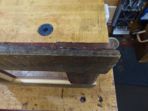

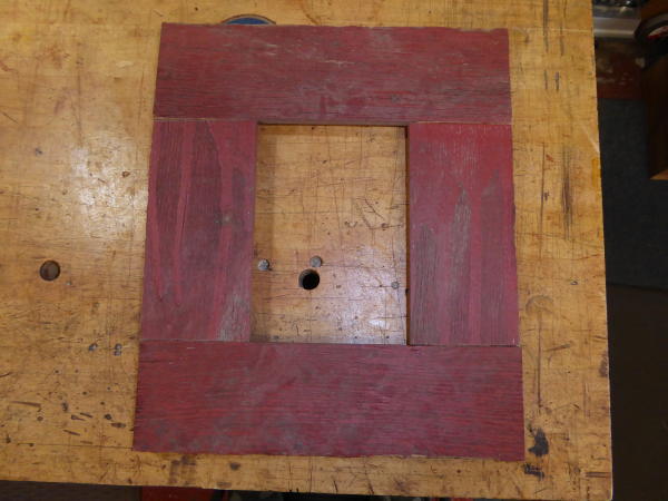

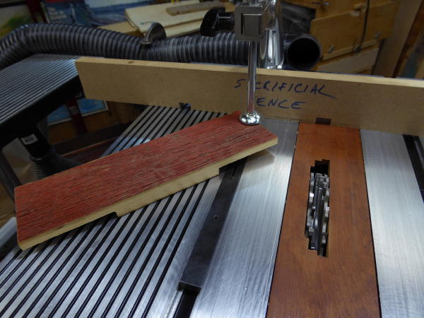

Here are pics of the project and steps. I decided a half-lap joint fit the rustic nature of the project better than miters. Given that the object was to preserve and show as much of the barn wood I decided to make the sides 3”.

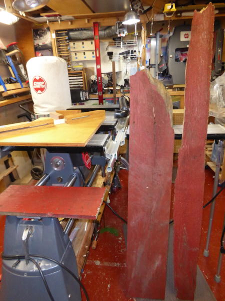

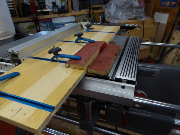

I removed the nails and laid out the rough pieces on the back side of the stock. I used a cross cut sled to rough cross cut all the pieces. I used the straightest edge of each piece to register against the back of the sled.

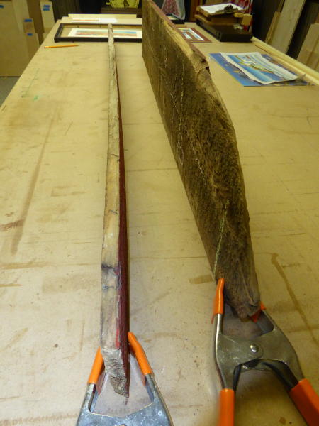

Next, I marked the stock for a 3.125” rip and used the sled pictured to rip the stock preserving one original edge, to be on the outside of the picture frames when completed and the straight cut edge could be marked and be the reference edge when cutting the half-lap joints. I cut a 4.5” x 5.5” gauge that would be the open area of the frames and could then lay out the four pieces of each frame to a) trim to final length and b) to mark for the joinery.

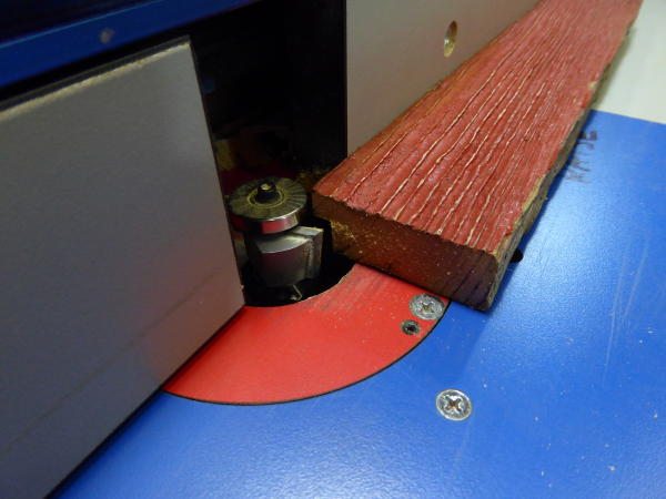

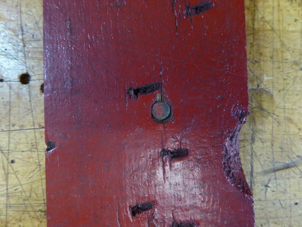

Cut the joints creeping up on the fit. (The SS gauge that allows you to make tiny incremental changes to the table height worked great!) I cut the .25 x .312 rabbit on the router table. Glued it all together. On all the cut edges I used a couple of things to “age” the wood. I made a batch of white vinegar and steel wool. This darkens the wood but doesn’t gray it. So I mixed up a bit of acrylic paint to make a gray and wipes it on with a damp rag. You can see the inside edge with the fresh rabbit next to the “aged” stock. I put the nails back in as I completed the project. Thanks again to all who offered suggestions.
