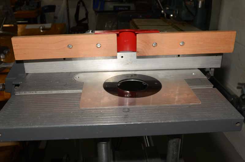

This is the top with a 1/4" aluminum insert recessed into the table.

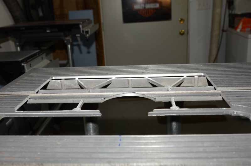

Here is the machined 510 top.

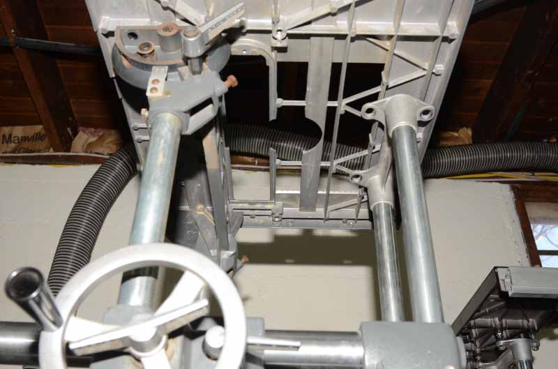

The underneath, I moved the carriage assembly to the left using 2 of the 4 bolts that use to secure it. I took a set of extension legs which I am fabricating to attach to the table and insert into the SPT end of the unit. This will allow the unit it be supported, along with the raising and lowering of the table. There is plenty of "meat: in the table to support the plate and router.

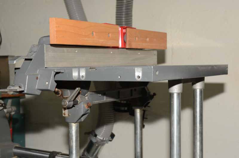

This is the unit to date. I've got enough room for the router between the legs, The combination of the table legs and the extension legs secure it with no movement.

I had 1/4" milled out of the top and as you can see in the picture, it left just some of the ribs exposed, but plenty strong enough to support the plate and router. So I guess the "War & Piece" version of the answer is yes it is a 1/4" plus.
I should get the "final" plate from the shop with the holes drilled for attaching the router next week. Then I'll need to cut back a few of the exposed ribs so the router sits flush on the plate. Then I plan to fabricate some plates/nuts to the table to attach the extension table legs with some bolts, then it will be on to the fence.

The square section is a little too big. I asked to have it milled the size of the standard router lift (8 3/4 x 11 ?/?) but include the ears.That way it could accept the lift at a later date. But it is what it is...
