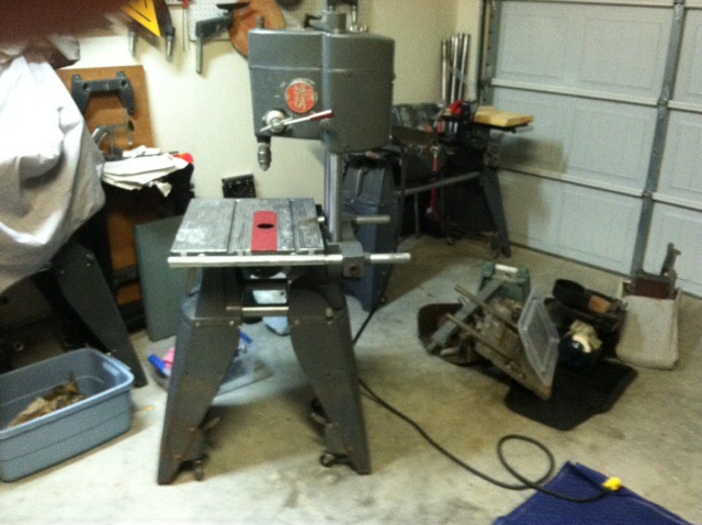

If you plan on using it in drill press mode.[ATTACH]26924[/ATTACH] motor reversed in this picture but you can see it limits the space between the table and the drill chuck. You can always remove the table for more room.

2centsworth wrote:If you plan on using it in drill press mode.[ATTACH]26924[/ATTACH] motor reversed in this picture but you can see it limits the space between the table and the drill chuck. You can always remove the table for more room.
Cut the bench tubes only, leave the way tubes full length and this 'problem' goes away.;)
Not sure re table removal.:rolleyes:
cooch366
Posts: 337
So this is?
Post by cooch366 »
A. A mini
B. A shorty
C. Just a drill press:)
Inquiring minds want to know?
[quote="JPG"]Cut the bench tubes only, leave the way tubes full length and this 'problem' goes away.]
cooch366 wrote:A. A mini
B. A shorty
It is what you want it to be.:) The 'name' does not matter.
'Generally' if it still can function as a table saw, it is a shorty, if too short for that, a mini. Opinions vary as to the 'ideal' length.
For a 'power station', it depends upon what you intend to power.;) Too long can be circumvented up to 4" with the quill.
