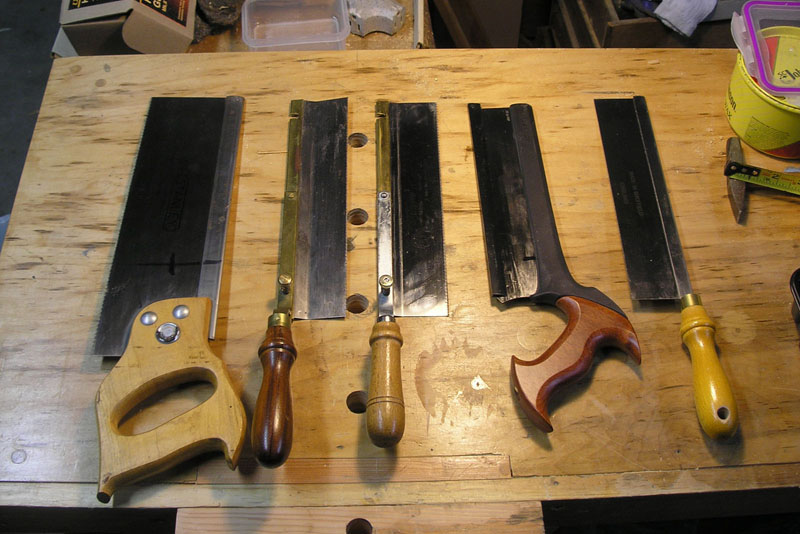

Here is a picture of the 5 saws I grabbed for my 'mini-test':
[ATTACH]26984[/ATTACH]
The five saws are (right to left):
A common 'gent's' saw for dovetailing
B Veritas dovetail saw - 20 tpi rip
C Crown brand - used for cutting trim, etc
D Two Cherries brand - again a trim saw
E Stanley 39-342 miter box saw (garden variety but older type)

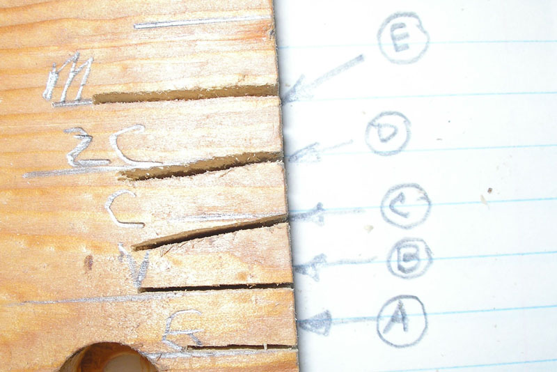

Then I took a piece of junk pine and made a series of short rip cuts - results:
[ATTACH]26985[/ATTACH]
[ATTACH]26986[/ATTACH]
The results, to my eye, are both expected and unexpected! The Veritas (B) is the best of the lot (no surprise there). The 'gents' saw(A) is next in line - a bit rough but fine and stays in line. The two trim saws (C and D) are pretty bad - the cuts are rough and, due to the blade offset, very hard to keep the cuts vertical.
The surprise is the Stanley (E). It had a nice cut quality, cut well and cut quickly. The handle is a piece less than pleasing but .... the darned thing did pretty good! I'll have to do something about that handle.

Are they all properly sharpened and set? Especially C and D! B and E appear as I would expect. A may be okay ( a little misalignment maybe ).
