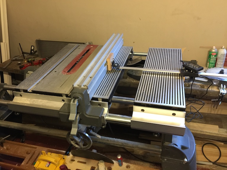

I hooked a digital readout up to my shopsmith.
The configuration is inspired by the Shopsmith Edition Incra TS-LS: the encoder is mounted on the auxiliary table with a clamp and the scale is attached to the fence.
To connect the scale to the fence, I used a magnet on a board that attaches to the t-slot:
I posted a few more pictures on my website, but I think the above basically explains how it works.
My cuts tend to be off by about .004", which strikes me as pretty reasonable. I think there's probably more play in the shopsmith and in my skill than in the scale.
One nice feature about this scale (iGaging 24-inch) is that it can display fractions of an inch, to 1/64.

I picked up a Wixey WR700 at auction a while back. I was wondering how I would adapt it to my SS, now I know. Thanks Owad.

I got tired of adjusting the height of the auxiliary table, and tried attaching the DRO to a floating table instead. The DRO is very light, and the table doesn't sag at all. With the configuration pictured below, it's possible to do cuts up to about 16.5" inches. With no gap between the tables, the maximum is 12.75".

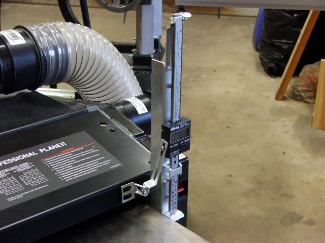

I added a Wixey digital readout to my Pro Planer.
