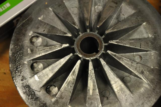

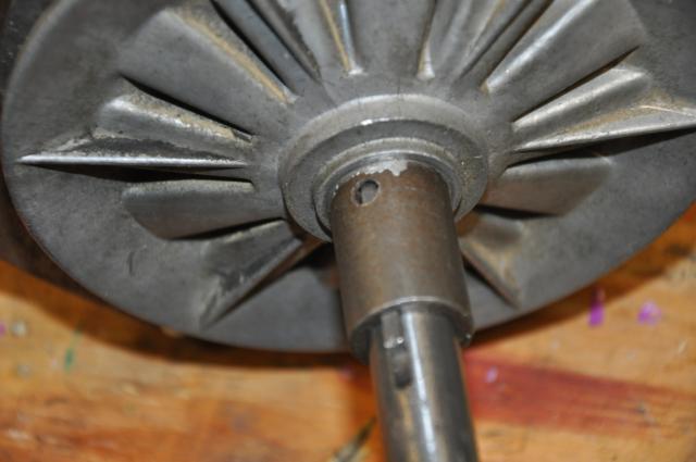

The reason I thought the "bushing" in the floating sheave was press in was appearance. It appeared to me to have a bronze interior and aluminum body, while the fan sheave looks to be all one material (aluminum)
Floating Sheave
Floating Sheave
floating sheave inside

I believe the floating sheave has a steel hub/bore with the aluminum sheave cast onto it.

JPG is correct, that "bushing" can not be removed.
The pit marks on the one sheave are interesting. Looks like the belt has sat in one position for a very long time. Try to remove them with some fine sandpaper. DO NOT GET TOO AGGRESSIVE!!!
When returning the fixed sheave on the motor shaft it should move along the shaft easily with very little wobble. Slide the floating sheave along the motor shaft with the key in place and there should be no binding.

Yes, the roughness makes me think it tried to run for a while.
I slid two small screw drivers along either side of a "finger" on the floating sheave. I'm not sure what moved, but the "stickyness" seems to be less pronounced than it was. Still present, but less.
I have cleaned the mating faces of both sheaves with denatured alcohol and they are pretty clean. I no longer think they are sticking due to anything on the surfaces.
Since the Fan sheave is all aluminum, while the Floating is 2 materials (steel hub/bore with aluminum body) I am actually wondering at this point if the Unit sat running and got hot enough (from friction from the belt) for the aluminum (lower melting temp that the steel "hub") to melt a bit and move on the bore. That could explain the pitting and the apparent misalignment. I am also noting what appears to be some type of "aluminum looking" flow at the mating surface between the body and the "bore", as if something melted there.
So I'm thinking of replacing the Floating Sheave (which to my mind seems a likely culprit) and the long key (just in case there's anything going on with it). worst case I will have to go back and replace the fan sheave if the problem remains

That "smear" appears on all of those sheaves and is a result of the manufacturing processes, In short as we used to say in Brooklyn "fuggetaboutit". :D
Bill V
Re: Sticky motor sheaves
That 'smear' was not caused by 'melting' there, but rather by 'solidifying' there! ;>|
