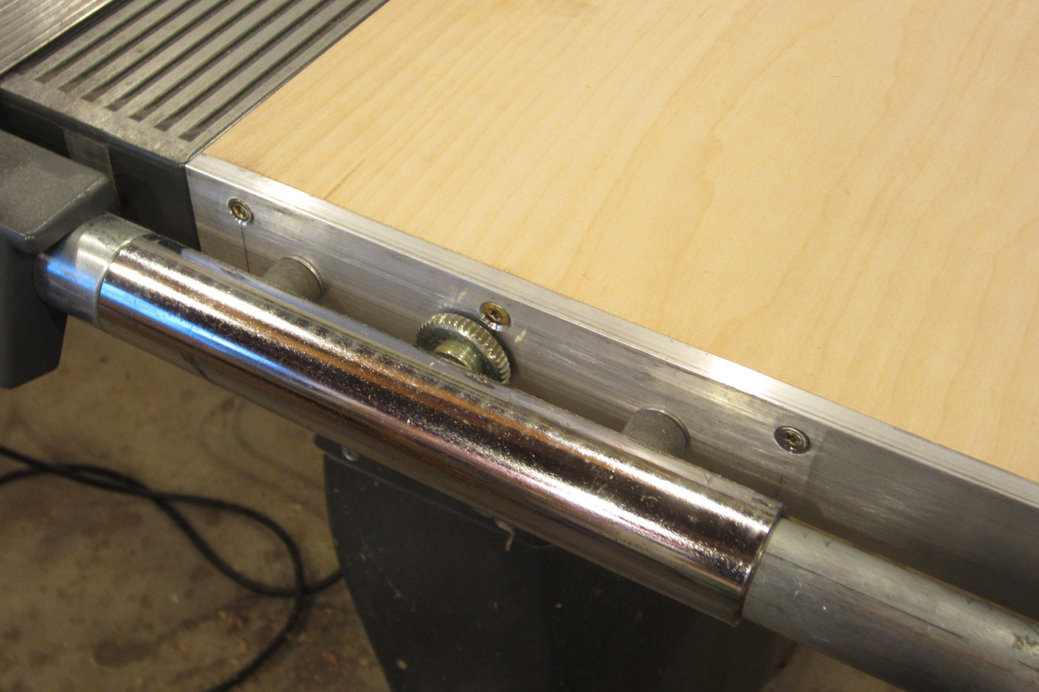

I just finished making a router table attachment for my Shopsmith 510. I was looking for a simple and clean solution.

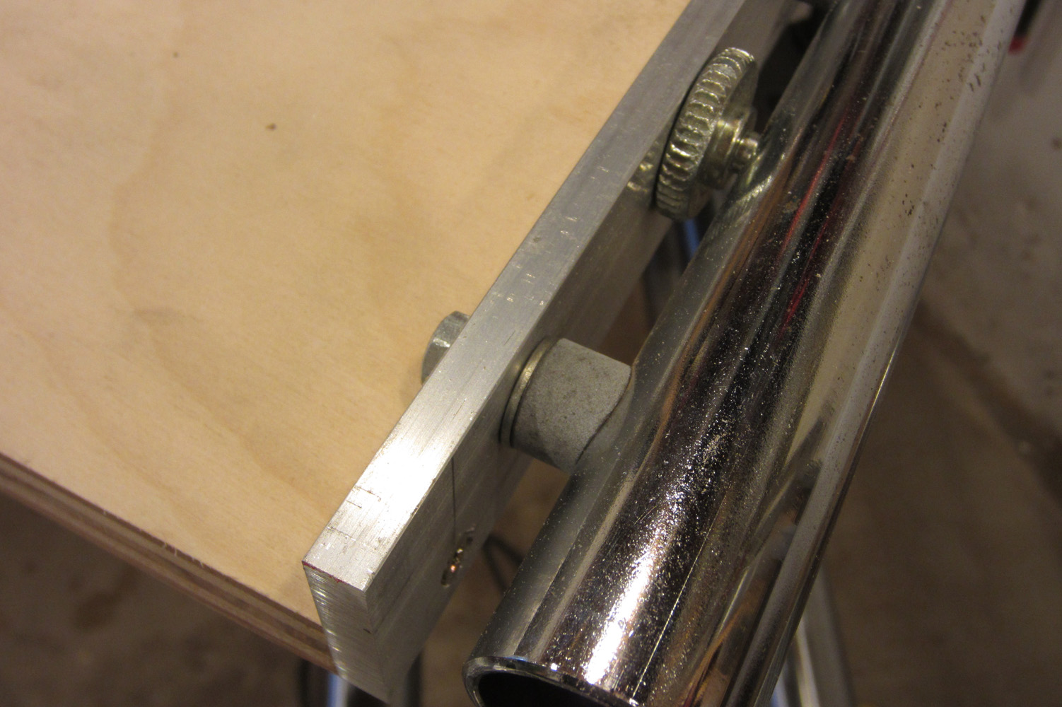

It measures 22 x 18 and is made of 3/4 birch plywood with 5/16 x 1-1/2 in. aluminum flat stock for side plates, plus the tubes removed from a small extension table bought on ebay. I had to use washers on the tube spacers for proper spacing. Threads were tapped into each side plate for the thumb wheels. I mounted a router base to the underside. I left enough room in case I add a plate mounting system someday.
photo of completed table
ss router table1.jpg (316.28 KiB) Viewed 10076 times
tubes salvaged from extension table
ss router table2.jpg (350.11 KiB) Viewed 10076 times
The underside
The underside
ss router table3.jpg (323 KiB) Viewed 10076 times
washer closeup
washer closeup
ss router table4.jpg (334.53 KiB) Viewed 10076 times

woodio wrote:I just finished making a router table attachment for my Shopsmith 510. I was looking for a simple and clean solution.

Very impressive. I shall try to copy it by taking a spare floating table apart. But what is the thread on the thumb Wheel? Clearly not metric, which most UK TAPS now are. Also do you intend to mount the table between the headstock and an extension table, or at one end, supported perhaps by the 510 telescopic legs?

You are correct the threads are US. If I recall they are 1/4-20 UNC threads. I mounted it one end. Legs are not needed unless you are routing some heavy pieces.
