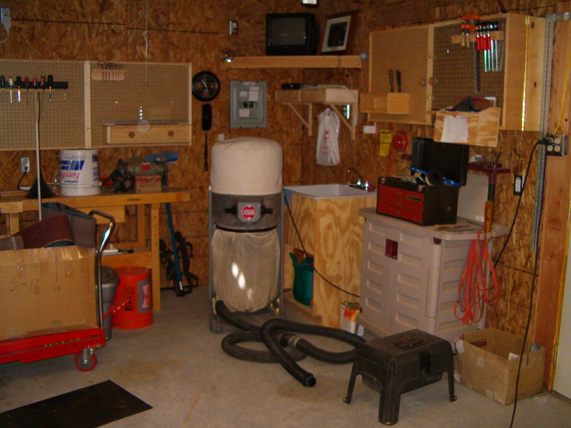

Before you settle on cabinet plans, you have to decide (take an educated guess) on how you will use the cabinets.
Will they hold saw blades?, hand tools?, magazines, books?, power tools?, Finishing supplies?, etc. Will they have doors?, will there be storage on the outside of doors? or will they be open? (No doors)
These decisions will dictate how deep, spacing between shelves, overall size the cabinets will be. Maybe all you need are shelves.
shop opposite corner.jpg (126.06 KiB) Viewed 3486 times

If you get a chance I would suggest you check out Woodsmith's website. They have a free set of plans for a cabinet that uses perf board. But, what makes it handy is that, in the front, it has two sliding perf board doors. These doors use fender washers, at the top, that roll in a slot.
It is a pretty beefy design that is a nice, robust size. I plan on building it this next month to go above my Shopsmith. It's size should hold all of my smaller Shopsmith accessories.
The Woodsmith website also has some nice designs for holding multiple table saw blades/disc sanders.
In my shop I have installed 2 sets of French cleats around the walls. This is based upon the design featured in Wood magazine. What I like about it is that as my shop evolves I can move my cabinets or my 2'x4' framed perf boards to different spots.
The 2'x4'framed perf boards fit nicely above the SPTs and hold whatever blades, sanding belts, or whatever accessories are needed for each tool.
A very similar design is featured on Canadian Home Wrokshop's website, for free.
