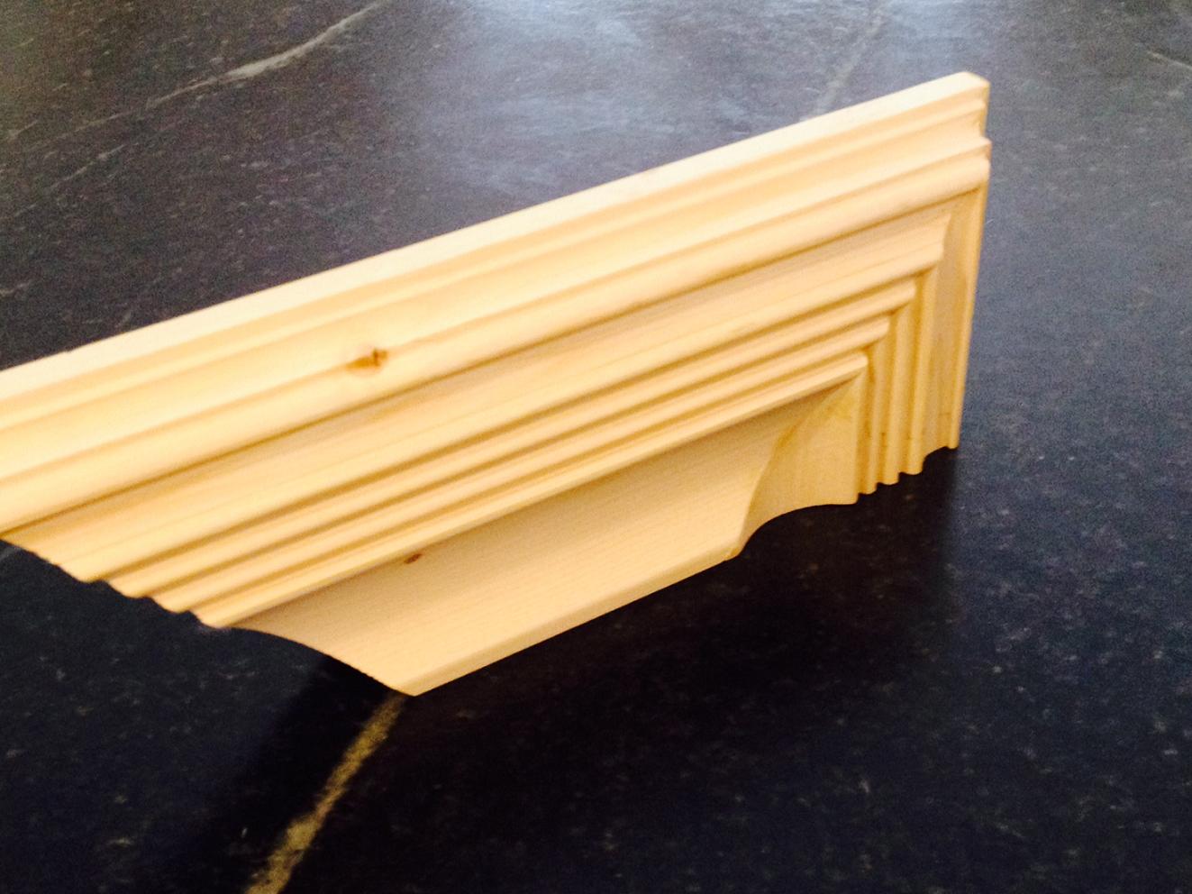

I recently acquired the molder head (two actually -- don't ask) and a handful of molder knives. The wife has asked for some picture frames for some prints and paintings so I decided it was time to try it out.
I read/watched everything in the Forum and on the Shopsmith site about the molder. There's really not that much out there about using the molder head so I though I'd post about my little experiment.
Because this was just test I decided to use some scraps of 2x6 that I had milled for another project.
The face profile was cut with the bead & cove molding molder knife (number 555038) in several passes until I achieved full depth.
FullSizeRender (2).jpg (136.7 KiB) Viewed 10437 times

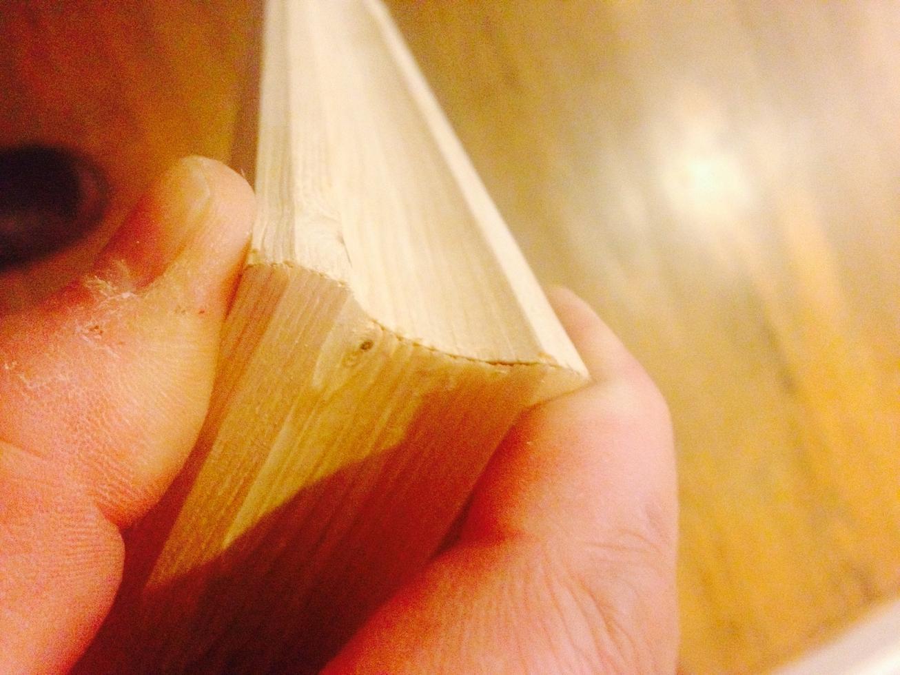

The cove in the side profile was made with the 1" flute molder knife (number 505573).

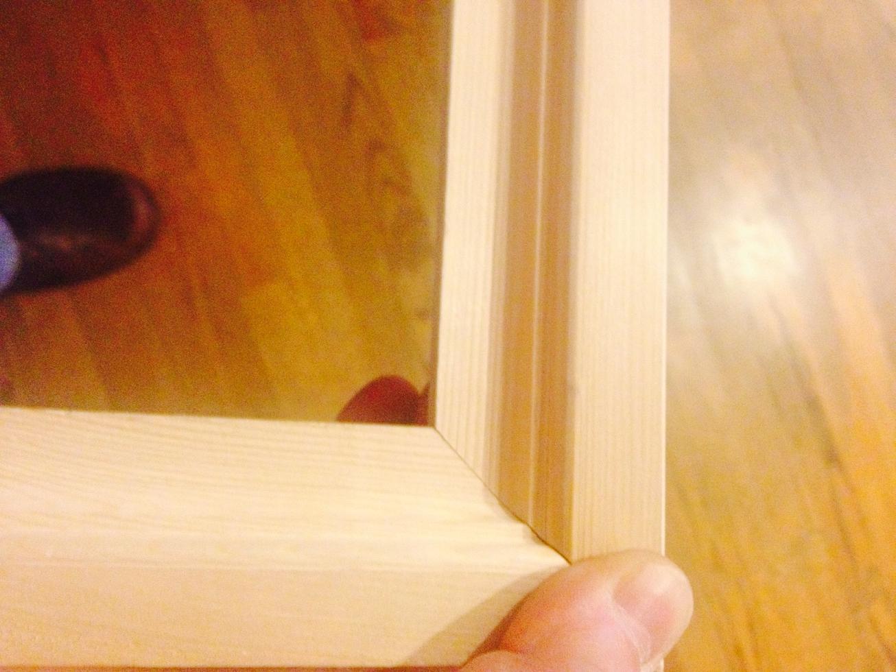

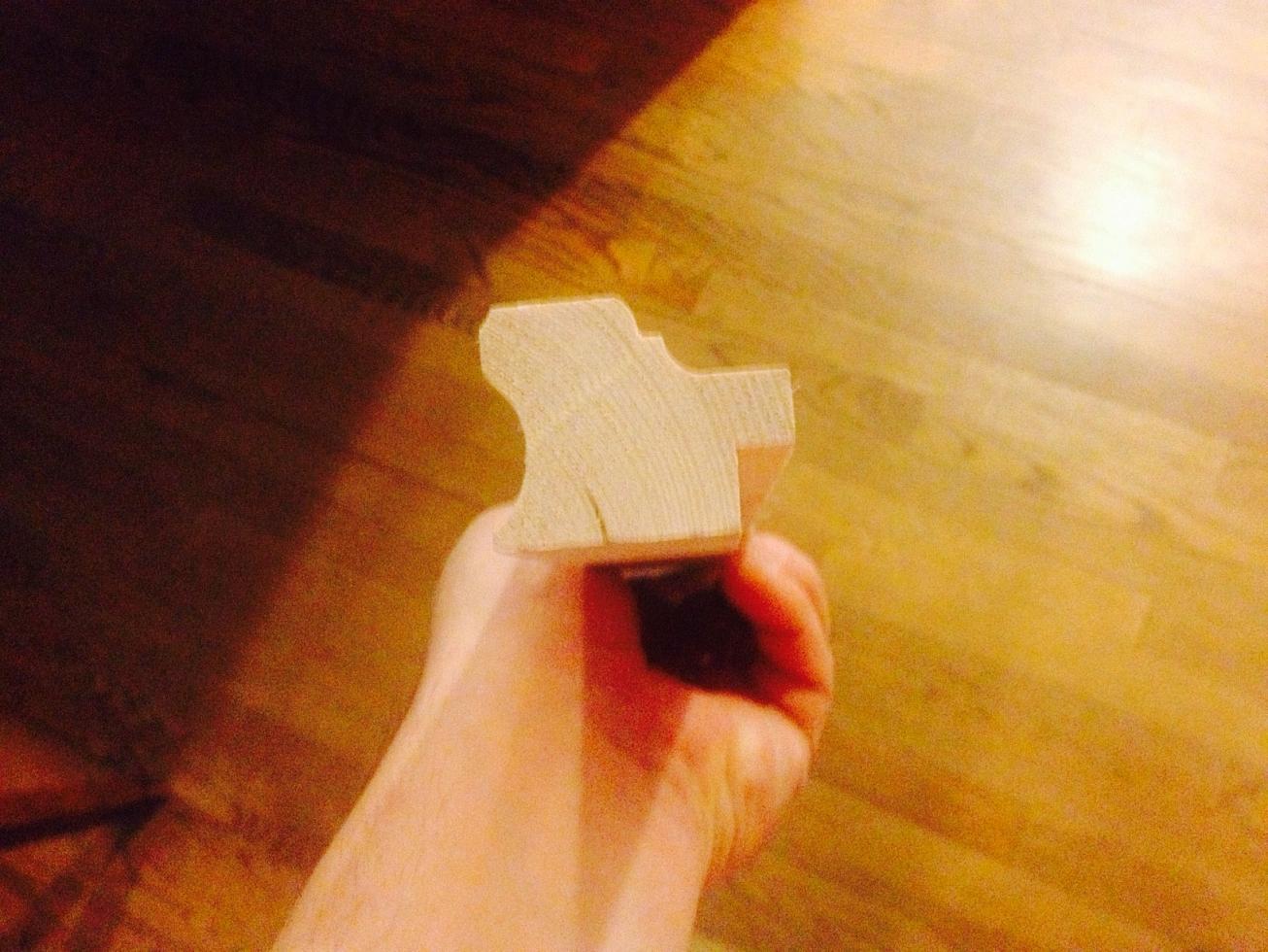

These photos are fresh off the molder head itself (and mitered) -- no sanding. Here's the end view:
All in all I think the molder has tremendous possibilities. I did make one mistake. When cutting the flute in the side I forgot to check the carriage lock. When I started the Shopsmith up, there was more vibration than I had experienced with the first cut (using the bead & cove knife) and the carriage drifted and before I could knock off the power I had nibbled a 32nd of an inch off of my molder table insert. :mad:

Continuing experimentation with the molder and a 2x6. We have some oil paintings with thick, wide, gold leaf frames and I'm trying to do something in the same style.
I am very impressed with what this tool can do with just the handful of profiles I have. The large cove was cut in three passes with the 1 inch cove knives mounted and a temporary fence set at 60 degrees to the cutter. Very little sanding was required. Much smoother than I could get using a table saw blade. I don't have the triple bead knives so the triple bead detail was made with the single bead knives and moving the fence progressively further from the cut. Makes me want more profiles!!!
FullSizeRender (3).jpg (135.03 KiB) Viewed 10247 times
Re: Mucking About With the Molder
Damn good looking 2 x 6 !!!!! :cool: :cool: :cool: :cool: :cool: :cool:
Nice joint also???? :confused:
I would call that a very successful experiment.
I think I see picture frames in your future. :rolleyes: Good 45'sbecome extremely important when you cut your own profiled lumber. I tried a couple picture frames to ascertain that I was ready for cove moldings. I was NOT. :(
