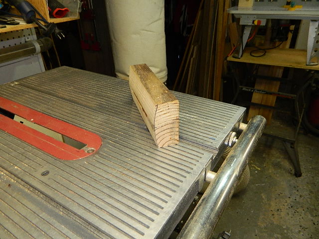

Still working at this.
My latest attempt was to follow "rcplaneguy's" advice and use the table saw blade. It worked to a good depth, but of course the slot is not straight right through, deeper in the middle, shallow at the ends due to the shape of the blade. I was hoping to avoid going right through the wood so am now trying to find a router bit that might do the job.
Another thought I had and might try is to use the saw blade method on a thinner blank, go right through, and then glue a second piece on the back to give it the overall thickness I want.

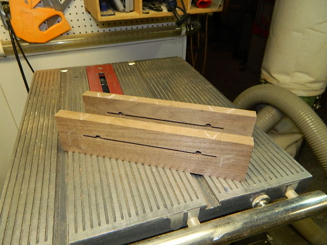

Well I'm back. I have been working on a couple of designs that cheat a little but I hope will give me a nice finished project.
The first was to use two boards, drill the mounting holes through them and then rout a groove through the face board and only part way through the back board. As you can see by the picture, even though my test piece had the groove centered, as I went deeper on the real pieces it got off center to the mounting holes. I'm not sure if I can salvage this piece but I will try.

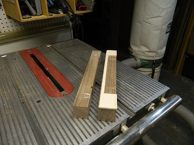

The second project uses a contrasting wood to be sandwiched between the two main pieces. The contrasting wood is cut out to form the groove to receive the keys. The glue ups are done but not perfect so I now have to do a bit
of fine tuning to get it right. Hopefully I will have final project photos of this one soon.

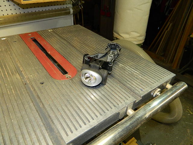

I also found a new best friend in the shop. We had bought two of these to give as gifts, but I needed good light to oil a recirculating pump motor so I tried one out. It worked so well I thought I could use it in the shop. Due to a combination of poor lighting and aging eyes, I don't see as well as I used to. The headlamp worked great.

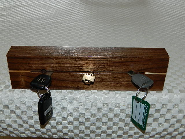

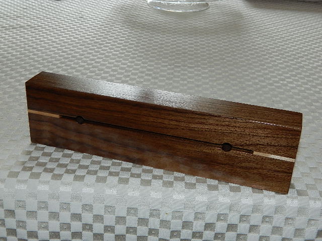

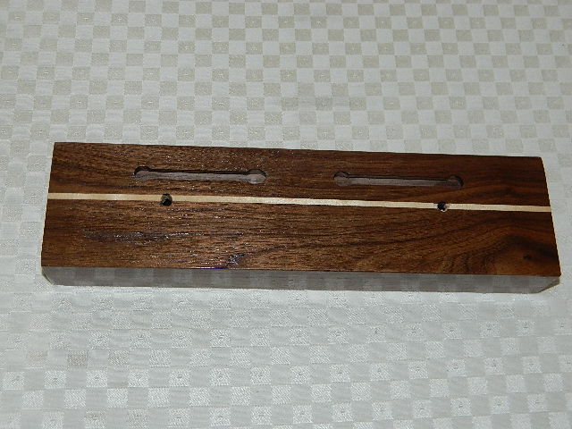

I finally finished this project. The combination of walnut and maple matches somewhat the valet tray I made for this same grandson last year. The depth is about 1/8" less than I had hoped for so car keys don`t go in quite as far as I would have liked,(next time). I also learned by mistakes that I hope not to repeat in the future and make life a little easier. It is finished with six coats of wipe-on poly. Too glossy for my liking but I could not find any semi-gloss wipe-on.
In addition to the installation holes on the front, I routed a couple of keyhole slots on the back as an alternative installation method
In future editions I might eliminate the screw holes in the front and only go with the keyhole slots, though they do add a bit of a design element.
