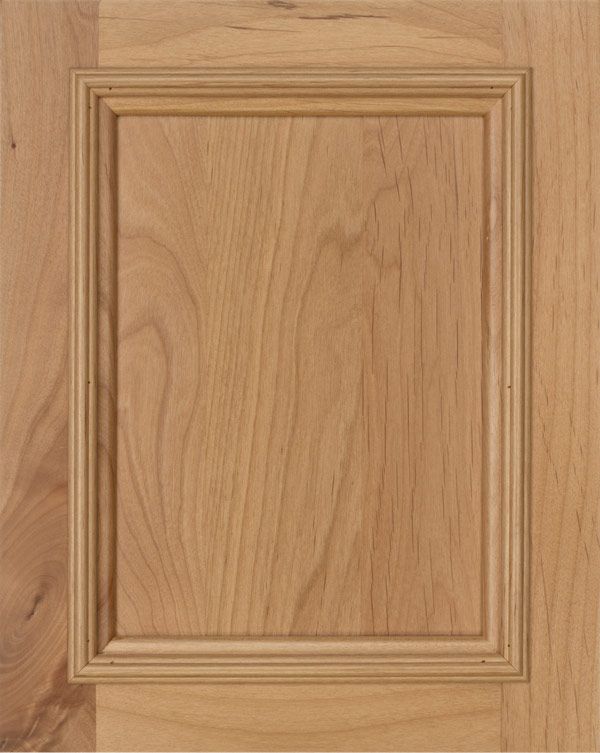

OK, here is a somewhat clear example of what I am trying to say LOL.
This door obviously (and if it doesn't pretend it does LOL) has a separate cut molding piece placed into the inner "hole" to "fake"? a floating panel where in actuality the panel is just sandwiched between two pieces of stock (the frame and the molding piece) while ...

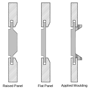

this is a true panel "floating" in the groove in the frame.
I take it from Gene's comment (probably erroneously) that the fist example above shows a plywood panel in the center?
